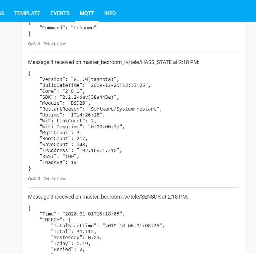

Hi David,
So, if i turn off my current “Fix” (Setting SetOption19 1 as an automation on HA start), I dont get my sensor info through;
However, there is MQTT messages flowing into HA;
And checking SetOption19 in the console, confirms it is still on;
And still, as per previous behaviour, if I set SetOption19 1, everything starts to show up again in HA. Very odd.
