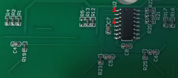

  • Connecting ground and what I marked in the image below as 1
  • Connecting ground and what I marked in the image below as 4
