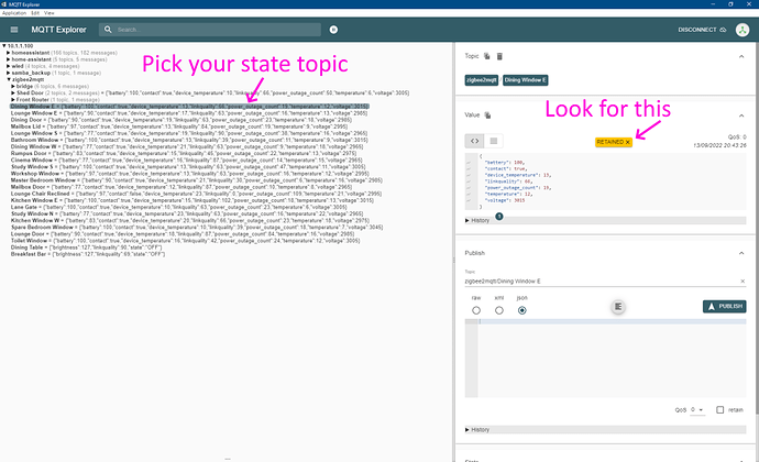

Have you inspected the broker to see if the state messages are already have the retained flag set?
Only the state messages.
You do not want to retain the command messages. This will cause all sorts of weird ghost switching.

Download MQTT Explorer, connect to to your mqtt broker and look to see if the state topic has retained messages when you use the Tasmota integration. It may already be done for you.
To see if a topic is retained look for this:
