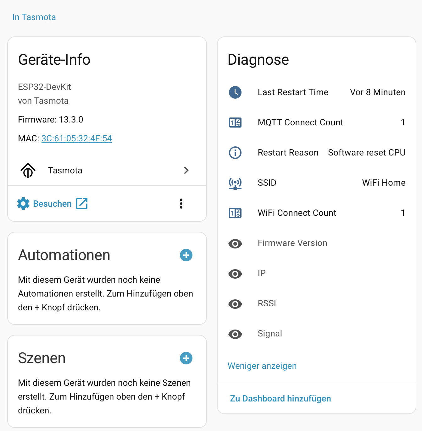

Hey I’m new in Home Assistant and need some help.
There is an ESP 32 flashed with tasmota which is collecting an signal from a bell as input to use this signal as automation trigger.
I connected the device via MQTT to my HA with Tasmota integration and see some Entities but I’m missing the sensor Switch1 state:
If I take a look with a MQTT broker the sensor Switch1 state is general available:
This is the console of the tasmota device where the sensor switch1 is also present:
I tried some points like SetOption19 0 but without any success. Any ideas what I can check to bring this running?
Thanks!

Hi Cinigua ,
Have you restarted HA so it re-scans for new entities? Sometimes your settings will require this, and no I don’t know which settings.

Well if the Tasmota integration is enabled, setoption19 set to 0, you should see anything that shows in the Tasmota console.
I have seen where things get stuck, try turning setoption19 to 1 (on), restart the device, then turn it back off (0), restart the device and see if it imports then.

I tried another module configuration in tasmota and now I can see the values in Home Assistant.
Interesting to know and now it seems like it is fixed
