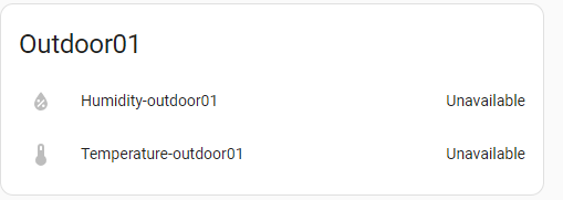

Ive moved to ESHome which is actually easier and more flexible than Tasmota but…
Again, I’m back to same problem, my device is showing Unavailable status while deep sleeping.
Readings are going fine once device is awake:

Is there any chance that HA will show(keep) last reading rather than displaying “Unavailable” ?
