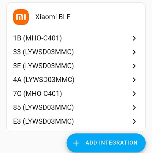

@ IOT_Ninja - they don’t look too different from mine.
Also, D’Oh!
I just went with ESPhome as per @ nikito7’s suggestion.
I had to update my instance andget the Mi sensors updated to 3.8 for the BThome advertisements but they get automatically detected.
esp32_ble_tracker:
bluetooth_proxy:
active: true
Seems to work OK even on Arduino as I couldn’t get ESPHome Bluetooth Proxy to work - I have a ESP32-C3.
I started with a basic install from Web - ESPHome and added from there.

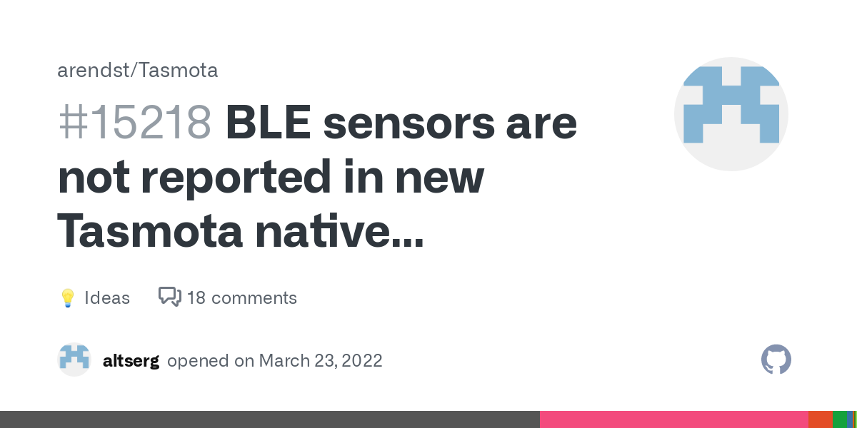

This topic finally helped me get this working too. It’s painful that Tasmota’s HA Integration doesn’t work for Auto Discover
HA autodiscovery for Tasmota BLE devices still not working / sensors have to be manually created right? just double checking if this is still not fixed.
thx
What should be fixed in tasmota? Data is sent out from ble device. It’s HA implementation which doesn’t evaluate devices out of the MQTT message.
Correct. The issue is the HA integration not auto discovering BLE devices / having to manually create the devices. On my end I decided to use OMG for BLE devices as the integration provides auto discovery. Still would be nice to see the feature implemented for Tasmota/BLE.
But in that case it should be with HA team to enhance the implementation instead of requesting workarounds in the tasmota sourcecode? Other tasmota devices have a auto discovery function in the HA implementation.
Agreed. Orignal issues/requests date back to the setoption19 “on” discovery, prior to the Tasmota integration handling autodiscovery. If not already done I guess a feature/fix request needs to be opened with HA. I have moved BLE to OMG so not an issue for me.
