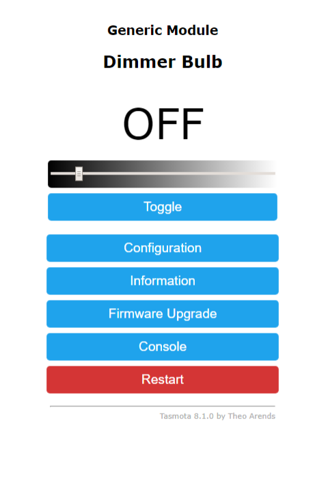

Pano you dont bother me and i am glad if i can help. The ESP-12 to be flashed and work stable needs some pins to keep high with pullup resistors. So i have soldered 10K resistors to these pins and Vcc. Its really great and cheap solution because these bulbs have really strong light at full power and with intergation with home assistant you can many any automation and also control them with voice commands through google assistant. I made some print screens with Tasmota menu to show you. (Ελλαδα για πάντα!)
