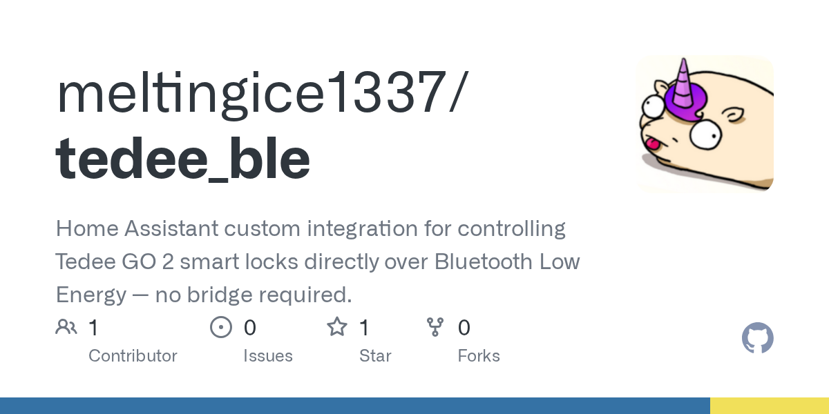

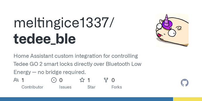

Hey everyone,
I built a custom integration to control Tedee smart locks directly over BLE no bridge needed.
I have a Tedee GO 2 and got frustrated with needing the bridge for any kind of automation. So I used the official documentation and SDKs of the BLE protocol (it’s basically TLS over Bluetooth, Tedee calls it PTLS) and built an integration that talks directly to the lock.
How it works: You need a free API key from the Tedee Portal (Device Certificates scope and Device reads to list devices). The integration uses it once to register and
grab a signed certificate, after that everything runs locally over Bluetooth. The cloud is only hit every few days to refresh the cert. Lock, unlock, open, all BLE, all local.
Entities:
  • Lock (lock/unlock/open, shows jammed state, last user & trigger source)
  • Door sensor (open/closed)
  • Battery (percentage + charging state)
State updates are pushed in real-time over BLE notifications, no polling. Connection stays alive with keep-alives and reconnects
automatically if it drops.
Also threw in a custom Lovelace card that auto-registers, shows lock state, door, battery, and last user in one row with contextual
buttons.
What you need:
  • Tedee GO 2 (other models might work, haven’t tested)
  • Bluetooth on your HA host
  • API key from portal.tedee.com
Available through HACS as a custom repository.
