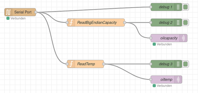

This is how my configuration looks like
The first node connects to the serial port with the right baudrate and sends the byte buffer it receives to the next nodes. It does so after a timeout of 10s. not receiving any new bytes anymore.
The ‘ReadBigEndianCapacity’ Reads the 2 bytes in the buffer and converts them to the left fluid capacity

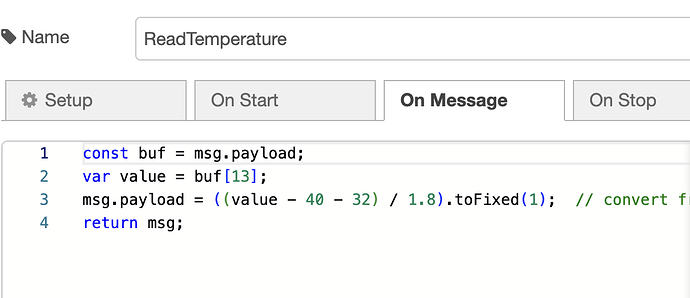

Same for the temperature (comes in handy) with function ‘ReadTemperature’
With the sensor node, we create a sensor which can be picked up automatically in HomeAssistant. This example is for the capacity censor.
The debug nodes give info with every receiving of data, especially because you only get data once / half an hour it takes a while to be able to debug. I used my other serial port which has an energy meter hooked up, to experiment a bit faster in the first stage of debugging. Have fun !
