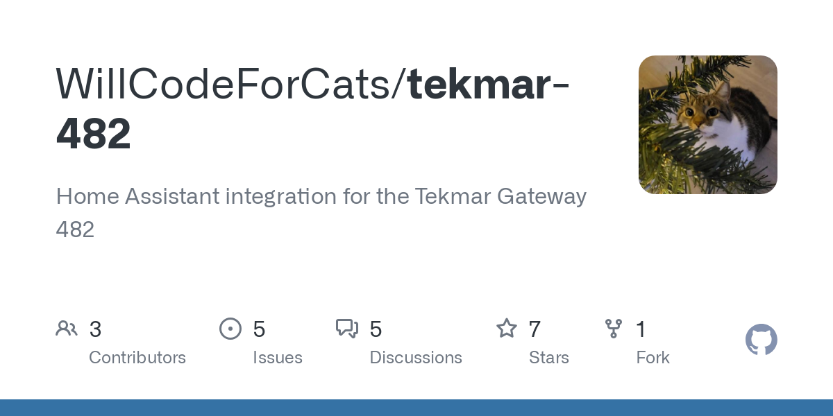

I made an integration for TekmarNet thermostats interfaced through the Gateway 482, but there are only a certain set of thermostats that work this way and none of them are the wifi or app models except for Snowmelt 670/671.
So there is an API for TekmarNet, but not a cloud API for wifi/app based thermostats.
