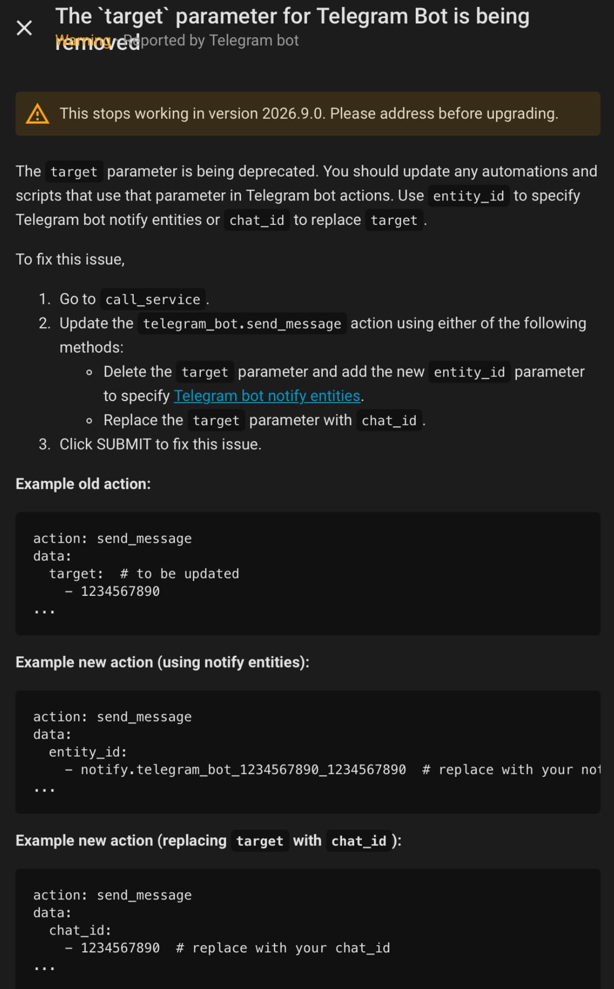

I’m getting the error message in HA about Telegram Bot and the Target parameter will be removed, see screenshot. I’m searching in my automations and in my configuration file, but I cannot see the Target parameter being used in combination with Telegram. Why do I get this error message? Suggestion on how to debug this

I thought I had changed all my config but the repair re-appeared. Turns out it was in the Alarmo Notifications actions. You can change the target to chat_id in the yaml view in the Alarmo Notifications.
If not Alarmo then check any packages or blueprints.

Since removing from my config (and alarmo) the repair has not come up again. So it must be still in your config somewhere.

It’s not a bug. You still have target specified in your notifications somewhere.
I probably don’t understand…
The repair says:
action: send_message
target: # to be updated
- 1234567890
I searched for “notify:”, “notify”, “send_message” in all my yaml and jinja files and I found nothing.

I believe the issue stems from the Blueprints Frigate Notification.
Re-import the Blueprints Frigate Notification.
Note the version before and after.
I upgraded from version 0.14.0.2w to 0.14.0.2x.
Do not forget to restart HA.
