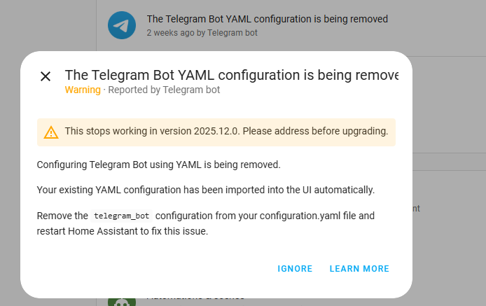

No. It’s not being removed.
The legacy yaml configuration of the integration is removed.
So from now on you set it up in UI.
Many other integrations has done the same change.
So you can remove the yaml in the configuration and it should work without it.
Make a copy first though

Where exactly in the UI is the config moved to? I have the Telegram integration which is marked as legacy now and there seems to be a new integration called “Telegram bot”. My questions are should I remove the “Telegram” integration and install the new “Telegram bot” integration? I removed the config from my config yaml and my telegram messages are working. This change is a bit confusing and the documentation for what exactly needs to be changed is not great.
You can find it in the UI: Settings > Devices & services > Telegram bot
You should be able to see some entries there since the integration will automatically import from your configuration.yaml.

Yes, you can delete the telegram_bot: entries in your configuration.yaml.
That will resolve the “The Telegram Bot YAML configuration is being removed” notification.
