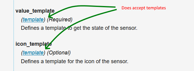

Edit: FYI here is how you can tell if a configuration option accepts a template:
