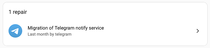

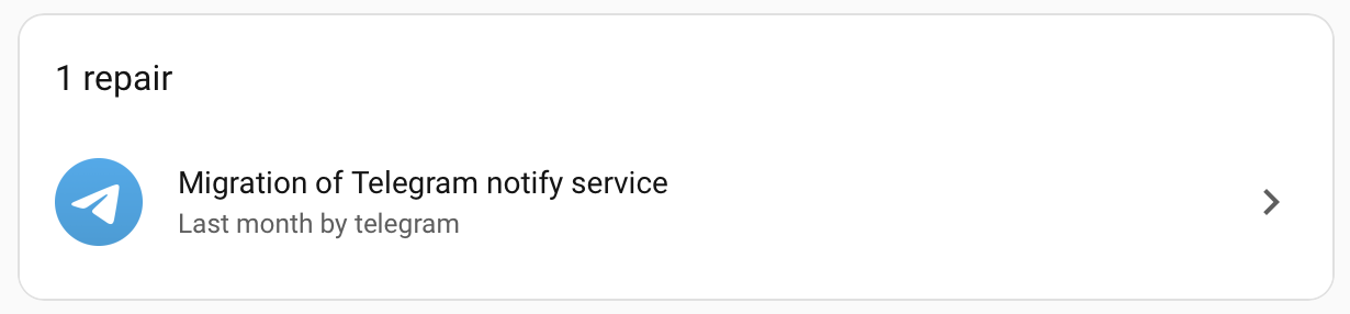

Telegram notify service migration (2025.11) not very clear
So, will this go away once I have successfully made all necessary changes?

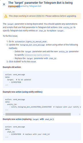

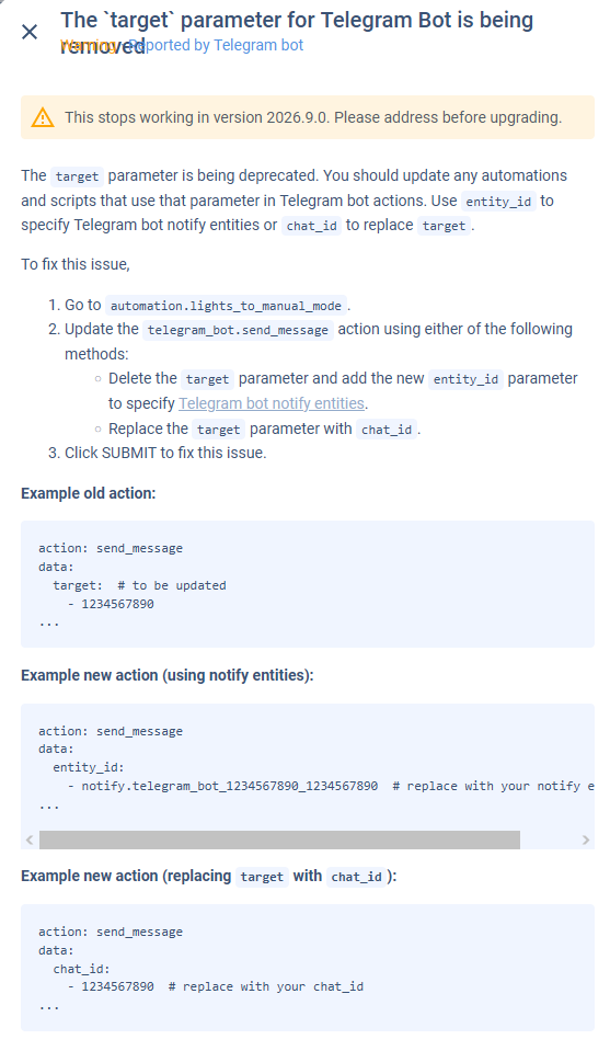

It would be so easy, if the repair message would just tell would should be changed, but why shall it be made easy for users?
The latest advise says, do not change anything and just ignore this message, and that’s exactly what I will do for the next 5 or 6 months.
It is a good choice. The integration is very much not finished. It will change with future releases. i.e. the ability to use entities instead of numeric chat ids.

Did you read this thread?
Why are you trying to migrate now when the advice is to not migrate now?
My only question is, why do we get this repair message too early.
can you please point out where it was stated “Not to migrate”?
I have to admit I’m not at 100% as I just just finished to manually migrate 228 issue for the template integration, but really I lost the part in this thread with the advice from the integration maintainer not to migrate.
Thanks
The advice was not coming from the maintainer, it was coming from Tom.
The Integration is not finished yet and it’s better to wait till it’s finished.
The HA popup about this is 100% unclear. And there are many topics about this, without any concise / simple informations about what to do.
Fully agree, so the best is to just do nothing and wait, till it’s described in a better way.

I’ve managed to make some progress on this I thought I’d share.
I have changed this:
  action:
  - data:
      message: Something important
    service: notify.telegram_mkjustuk
to be this:
  action:
  - service: telegram_bot.send_message
    data_template:
       target: 1234567890
       parse_mode: html
       message: "Something important"
  mode: single
Target is the chat_id you want to message.
There’s another change coming in March.
As I feared changing all 300 of my message actions was premature and they will all need to be changed again. :weary:
Also I have opened an issue about this repair as it does not follow the way every other action specifies a target in home assistant. So it may change again. See: Telegram bot is using non standard config for specifying a target entity id. · Issue #164503 · home-assistant/core · GitHub
