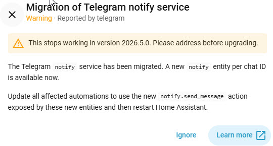

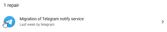

To pile on a little here, I’m also confused by this:
Clicking on the notification produces this:
Clicking on “Learn more” sends me to this link:
https://www.home-assistant.io/integrations/telegram_bot#notifiers
Which so far has not been useful for me to update my configuration. I’m having some difficulty comparing what’s at that link to what I see in my automation via the GUI. Not clear what needs to change.
Like the OP, I have some Telegram names and chat IDs defined in the “notify:” section of configuration.yaml. I also have some groups of Telegram chat IDs defined there.
Is there any other reference that more clearly shows what needs to be changed? I would prefer to keep my Telegram groups and reference those in some of my automations, so both individual chat IDs and groups need to be covered.
