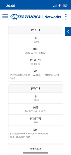

Not working
send_command_reboot_router: "ssh -o StrictHostKeyChecking=no [email protected] 'gsmctl -Q'"
{% set action_response = {“stdout”:“”,“stderr”:“Warning: Permanently added ‘192.168.1.1’ (ED25519) to the list of known hosts.\r\nPermission denied, please try again.\r\nPermission denied, please try again.\r\nConnection closed by 192.168.1.1 port 22”,“returncode”:255} %}

The error message suggests that the SSH connection is being denied due to authentication failure. Possible causes include:
Incorrect username or password (if using password authentication).
Missing or incorrect SSH key (if using key authentication).
Public key not added to the correct user’s authorized_keys on the router .
Permission issues on the authorized_keys file (should be 600) or the .ssh directory (should be 700).
SSH server settings on the router may restrict authentication methods (e.g., allowing only key-based authentication and no passwords).
Troubleshooting Steps:
Can you SSH into the router from another device (e.g., your PC)?
ssh -i /path/to/private_key [email protected]
If using key authentication, verify that the public key is in the correct location on the router:
cat ~/.ssh/authorized_keys
Check SSH logs on the router for more details (logread | grep ssh or /var/log/auth.log depending on the system).
Ensure Home Assistant has access
These are just some thoughts without having tested it myself.
You need to ensure that ssh connection to your router works, either with keys or with password (latter is less recommended).
I’m not very familiar with these things, I’ve never used ssh on the router. Is it possible that it’s not enabled? I’ll try to do some tests if I can
Thanks

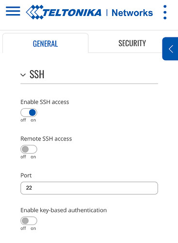

You need to enable ssh on your router:
System - Administration - Access Control - enable local SSH access (I don’t need remote access, because I connect to it via VPN).
Leave the port at 22 or change it and remember it to use the port number in the ssh command for connection.

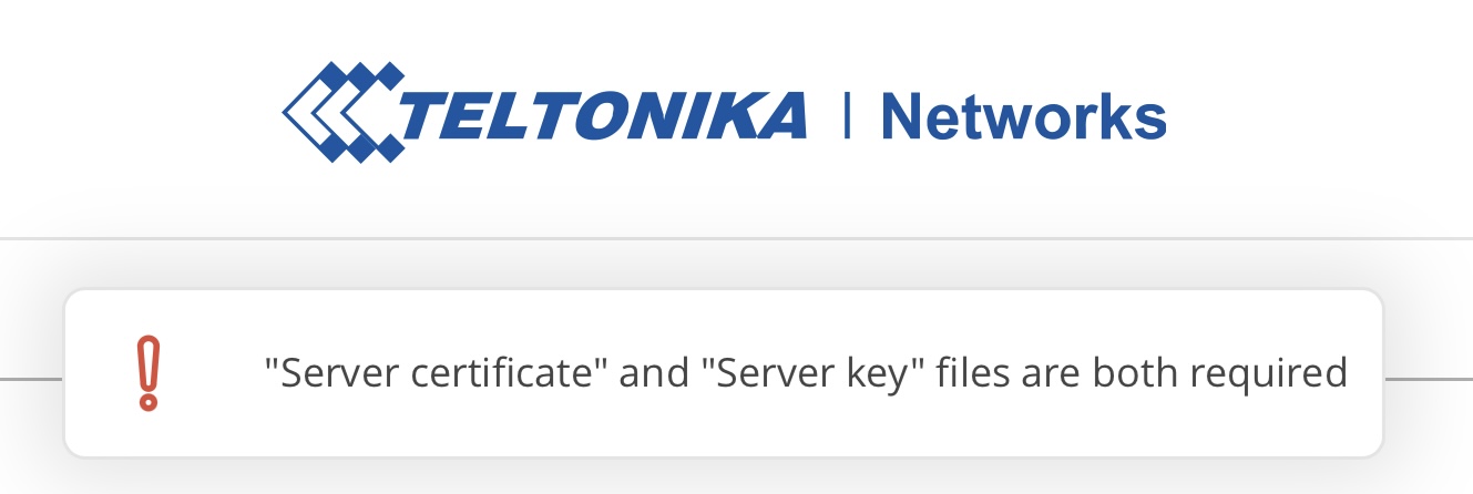

It’s enabled
If I enable “Remote SSH access”, it gives me this warning:

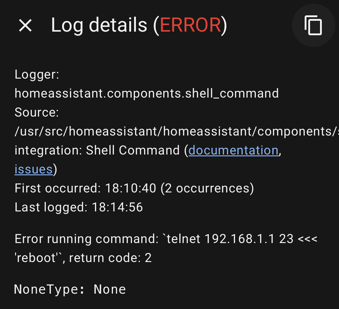

I also tried to enable Telnet on the Router, and send a Telned command from Home Assistant, but I always get this error:
shell_command:
reboot_router_teltonika: "telnet 192.168.1.1 23 <<< 'reboot'"
