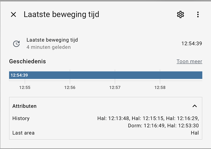

doing something similar with my last motion trigger template:
      - unique_id: last_time_motion_triggered
        state: >
          {{as_local(states[trigger.entity_id].last_changed).strftime('%X')}}
        attributes:
          history: >
            {%- set previous = this.attributes.history|default([]) %}
            {%- set new = [this.attributes.last_area|default('nergens') + ': '
                           + this.state] %}
            {{previous[-4:] + new}}
          last_area: >
            {{area_name(trigger.entity_id)}}
must check why I do this, and why it is shorter than yours, what am I missing there:

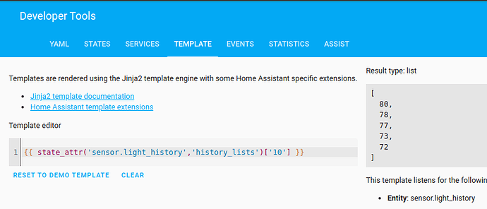

My test with seconds as the keys, a 5-second update and a list length of 5 (and a different attribute name to get rid of the prior data):
Then you can do, for example:
(one minute later than first screenshot so the 82 has been punted out)
You’ll have to work out how to deal with the n/a values if applicable.
