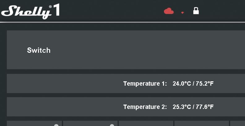

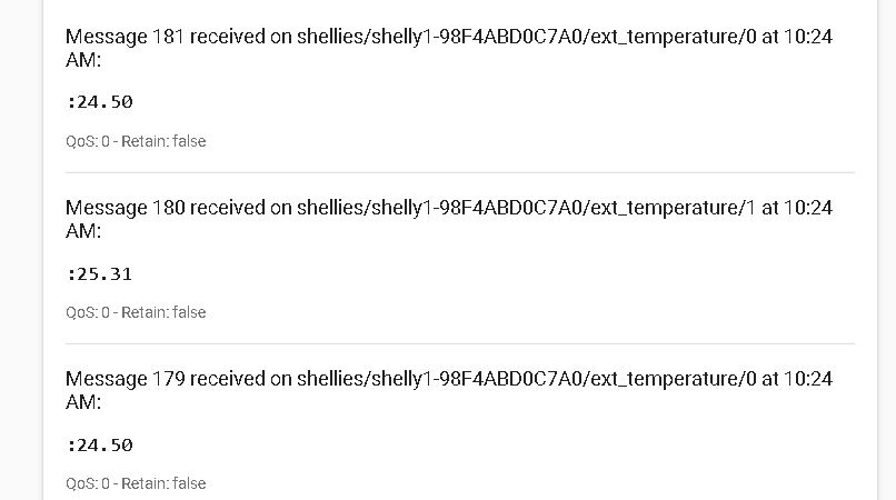

Okay, so I managed to build this together. You simply connect the wires (color coded) and it works. It sends temperature data via MQTT and also shows it in the Shelly interface. The relay itself operates normally in the meanwhile.
