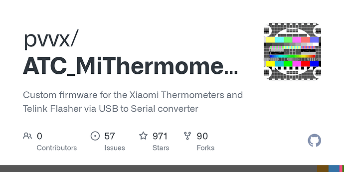

I’m not sure if what you ask is possible, as you probably know there are at least two groups working on firmware for these devices. I am still on the original firmware by @atc1441. I would do some searching of the github issues sections of both these repositories. And if someone has not yet answered your question, I would post it there. Most of the new work I have seen is by the @pvvx group, so that is probably a good place to start.
