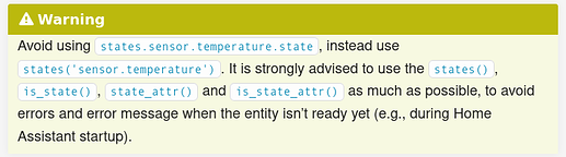

BTW, be advised that it’s preferable to use the states() to get an entity’s state value as opposed to attempting to get it directly using this format: states.sensor.whatever.state
The reason is because if the entity doesn’t exist, the template fails with an error. In contrast, states() will simply report None and the template continues with its evaluation. For more information, refer to the States section of the documentation.
