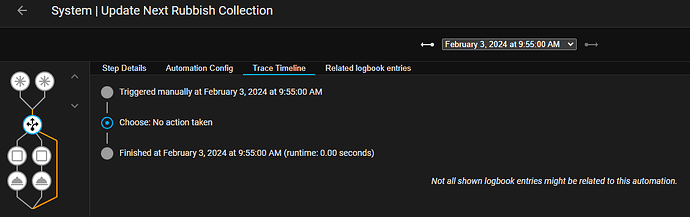

Below is the YAML of what I have, and attached is an image of what the trace shows me. For whatever reason, even though one of the sensors referenced does fall into the trigger critera, the actions are skipped.

From the trace, it looks like you executed the automation manually, didn’t you?
Then, there is no trigger being used, so all trigger conditions return false.
  1. What koying said. Executing an automation’s Run command only executes its actions. That means it skips the triggers. By skipping the triggers, the trigger variable is never defined. An undefined trigger variable means none of the Trigger Conditions will work.

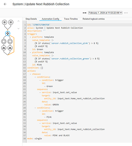

  2. Your two Template Triggers will never trigger because their template is comparing a string to a number. In addition, the template uses an if - then that reports nothing.
I suggest you change your Template Triggers to this:
    value_template: "{{ states('sensor.rubbish_collection_pink') | int(0) > 8 }}"
    value_template: "{{ states('sensor.rubbish_collection_green') | int(0) > 8 }}"
NOTE
Your Template Triggers report Green when sensor.rubbish_collection_pink is greater than 8 and Pink when sensor.rubbish_collection_green is greater than 8. Is that intentional or a mistake?

  1. The revised version of what you posted still uses an if endif structure which won’t work the way you think it might. Use the template I suggested.
  2. In your original version, the template tests if the sensor’s value is greater than 8. In your revised version it tests if it’s less than 8. That’s a significant change to the test. Which version of the test is correct?
