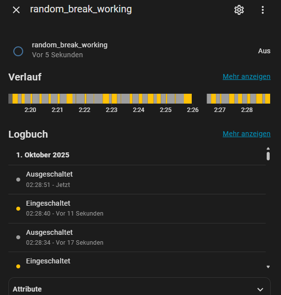

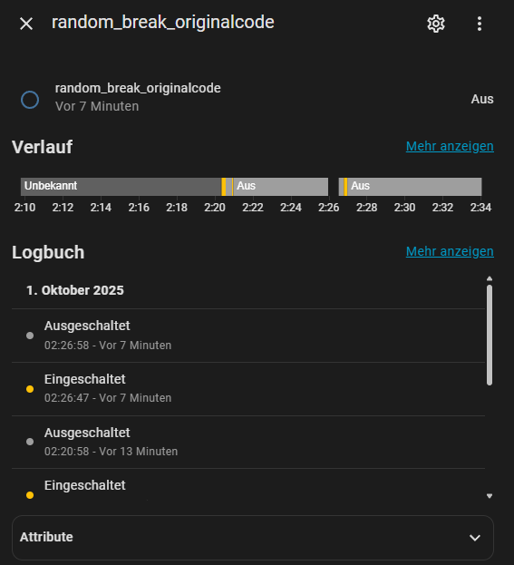

  - triggers:
    - trigger: time_pattern
      seconds: "/20"
    binary_sensor:
      - name: random_break_working
        unique_id: random_break_working
        state: "on"
        delay_off: "{{ '00:00:' + (range(1,15)|random|int)|string }}"
        auto_off:  "{{ '00:00:' + (range(1,15)|random|int)|string }}"
        attributes:
          updated: "{{ now() }}"

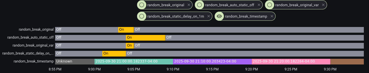

I set up a few variations using a 10 minute interval, and the issue seems to be present… after restarting HA or the integration they work one time again then stop.
Sensor configs
template:
  - triggers:
        minutes: "/10"
    actions:
      - variables:
          delay_on: "00:{{ range(1,5)|random|int}}:00"
          auto_off: "00:{{ range(1,5)|random|int}}:00"
          timestamp: "{{ now() }}"
    sensor:
      - name: random_break_timestamp
        state: "{{ timestamp }}"
        attributes:
          delay_on: "{{ delay_on }}"
          auto_off: "{{ auto_off }}"
    binary_sensor:
      - name: random_break_original_var
        state: "on"
        attributes:
          timestamp: "{{ timestamp }}"
        state: "on"
      - name: random_break_static_delay_on_1m
        state: "on"
        delay_on: "00:01:00"
      - name: random_break_auto_static_off
        state: "on"
        auto_off: "00:05:00"
The trigger seems to be working fine, since the timestamp sensor is updating…

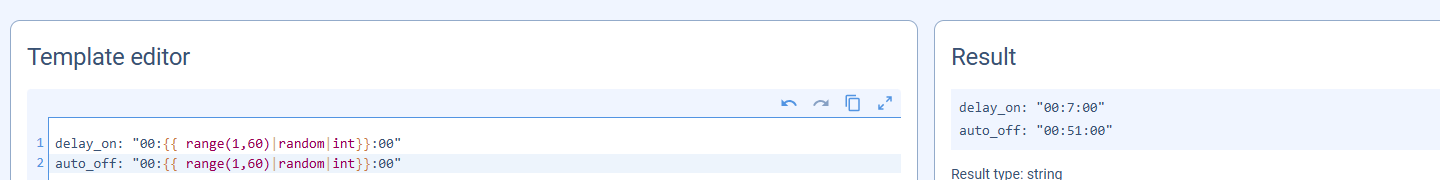

There is a missing leading 0 for the seven minute time (delay on) but I’m not sure that is an issue.

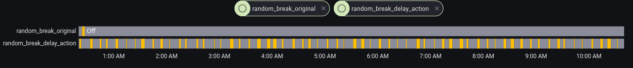

I think I found a work around… instead of using delay_on, use a delay action
template:
  - triggers:
        minutes: "0"
        seconds: "0"
    actions:
      - variables:
          delay_on: "00:{{ range(1,60)|random|int}}:00"
          auto_off: "00:{{ range(1,60)|random|int}}:00"
      - delay: "{{ delay_on }}"
    binary_sensor:
      - name: random_break_delay_action
        state: "on"
* NOTE: I only tested it with a 10 minute interval… I’m not sure how practical it is when working with the full hour.
