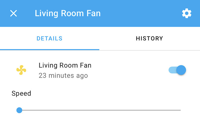

I’ve got an extremely simple fan template setup right now. For some reason, whenever I turn this template fan off and on again, the fan speed percentage becomes 1%, even though the input_number
helper still has its old value. For example, I would set the fan speed to 33% (my fan has 9 speeds), then turn the fan off. When I turn the fan back on, the fan speed for the fan would show up as 1% instead of 33%. When I check the input_number entity, it still shows as 33%.
Does anyone know why that might be?

I resolved the problem! It turns out I was using speed_template
instead of percentage_template
in the config! Once the config was updated, the percentage no longer resets. Perhaps the reason why it always “resets” was that speed_template
expected a much smaller value than the percentage value in my input_number.
Only noticed this as I was re-reading my post. I guess this was a case of rubber ducky debugging haha.
