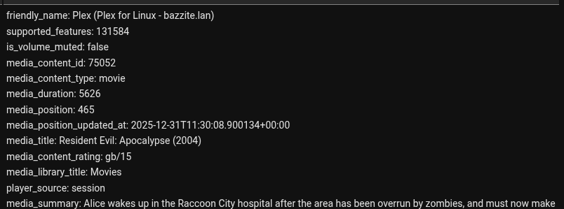

If you go to Developer Tools → States and type in your sensor media_player.plex_plex_htpc_for_windows_knc_htpc you can see a list of all attributes it supports, eg
