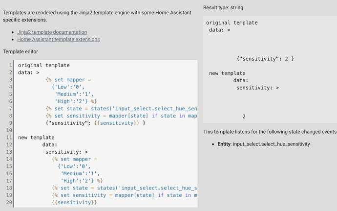

? Struggling a bit with the variables that are set in the beginning of the template.
this doesnt work:
    sequence:
      service: rest_command.set_hue_command
        command: config
        type: sensors
          sensitivity: >
            {% set mapper =
              {'Low':'0',
               'Medium':'1',
               'High':'2'} %}
            {% set state = states('input_select.select_hue_sensitivity') %}
            {% set sensitivity = mapper[state] if state in mapper %}
            {{sensitivity}}
coming from:
    sequence:
        command: config
        type: sensors
        data: >
          {% set mapper =
            {'Low':'0',
             'Medium':'1',
             'High':'2'} %}
          {"sensitivity": {{sensitivity}} }
thing is, I need the value to be the full line including the embracing braces and double quotes, just like it is posted here:
