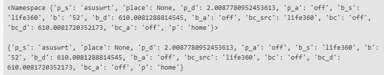

So I created a sensor with this state:
<Namespace {'p_s': 'asuswrt', 'place': None, 'p_d': 2.0087780952453613, 'p_a': 'off', 'b_s': 'life360', 'b': '52', 'b_d': 610.0081288814545, 'b_a': 'off', 'bc_src': 'life360', 'bc': 'off', 'bc_d': 610.0081720352173, 'bc_a': 'off', 'p': 'home'}>
But - I cannot access its attributes:
I can convert this “namespace string” to a “dictionary-looking” string:
{% set ns = "<Namespace {'p_s': 'asuswrt', 'place': None, 'p_d': 2.0087780952453613, 'p_a': 'off', 'b_s': 'life360', 'b': '52', 'b_d': 610.0081288814545, 'b_a': 'off', 'bc_src': 'life360', 'bc': 'off', 'bc_d': 610.0081720352173, 'bc_a': 'off', 'p': 'home'}>"%}
{{ns}}
{% set dict = (ns|string).split("<Namespace ")[1].split(">")[0] %}
{{dict}}
But still this “dictionary-looking” string does not work as a dictionary - I cannot do any of these:
{{ dict['p'] }}
{{ dict[p] }}
{{ dict.p }}
Probably I should not use a namespace? May be I should create some kind of dictionary and return it?
Or may be there is some 3rd way?

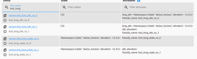

Created sensors:
accessing namespace in attributes - failed.
Dev tools with sensors w/o accessing a namespace:
Dev tools with attempt to access a namespace in attributes:
I have already said - accessing a namespace DOES NOT work - see my 1st post:
The only way which worked for a “long value as a state” case - is converting a namespace into json with some tricks (replacing ' with ", using from_json):

Oddly enough that the “source attribute” is presented as a dictionary (which does not happen when the “long value” is stored as a state) - see the 2nd sensor:
That is the normal behavior… States are always strings, attributes can be other data types.
Thank you for your clarification! It really makes sense.
Also, it explains (I guess so) why in case of using “long value as an attribute” there is no need to use “from_json”.

            ## convert namespace into dictionary
            {%- set dict = (nsLATEST|string).split("<Namespace ")[1].split(">")[0] -%}
            {{dict}}
