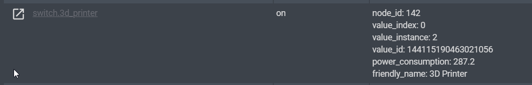

Not really sure what’s going on. I have this template sensor:
3d_printer_power:
  friendly_name: '3D Printer Power'
  value_template: '{{ states.switch["3d_printer"].attributes.power_consumption | float }}'
  unit_of_measurement: 'W'
Based on this switch:
Which gives this:
However, using said template in the web UI works as expected:
What am I missing here?

Your first suggestion worked, thanks!
I’m not 100% clear though why my code didn’t, especially since it evaluated in the web UI. You mentioned that it’s only evaluated once during startup but even with a value in that attribute I still got an unknown which mean it wasn’t actually read. There was a value in that attribute during startup so I don’t know what I got the unknown.
I get the fact that it may not update, I’m just curious why it never gave anything.
Thanks again!
