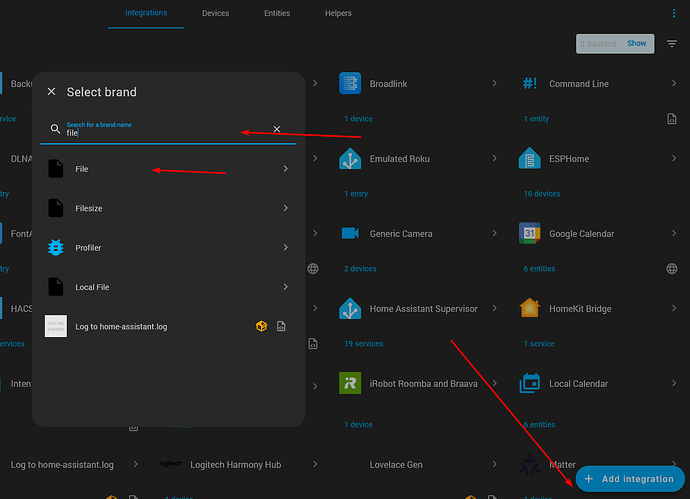

Yes probably this which triggered the Repair. But I’ve not found a way of continuing to use File within the gui.
So is adding command_line into configuration.yaml the correct solution or will that also be deprecated next?
Literally called File when you search integrations. :man_shrugging:
Ah ha brilliant thanks. I hadn’t appreciated that it was now achieved using this. I’ll remove the command_line from configuration.yaml and use this File integration instead.
