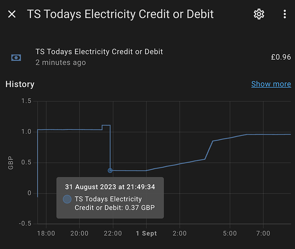

These are the value graphs. You can see the rest reset on the 9.50pm reboot.
