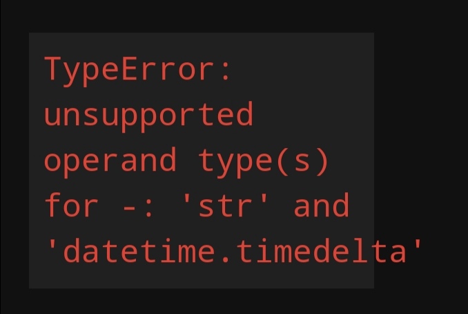

So unfortunately, I’m doing something wrong.
tom_l
November 25, 2020, 11:04am
9
What is the exact state of sensor.p30_lite_xxxx_next_alarm ?

tom_l
November 25, 2020, 12:33pm
13
I’ve been trying for ages to convert your sensor value to a datetime object and so far have not had any success. Maybe someone else can help.
{% set timedate = states('sensor.p30_lite_xxxx_next_alarm')|replace('T', ' ')|replace('Z', '+0000')|replace('.000', '')%}
{{ strptime(timedate, '%Y-%m-%D %H:%M:%S%z') - timedelta( minutes = 77 ) }}
Also please don’t post screenshots of text. I’m lazy and prefer to cut and paste the state rather than typing it all out. All you had to paste was 2020-11-25T17:56:00.000Z
