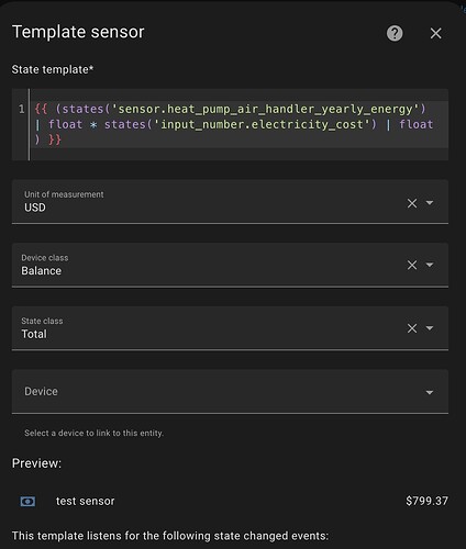

If I create a template sensor using a Helper, the template sensor works fine.
