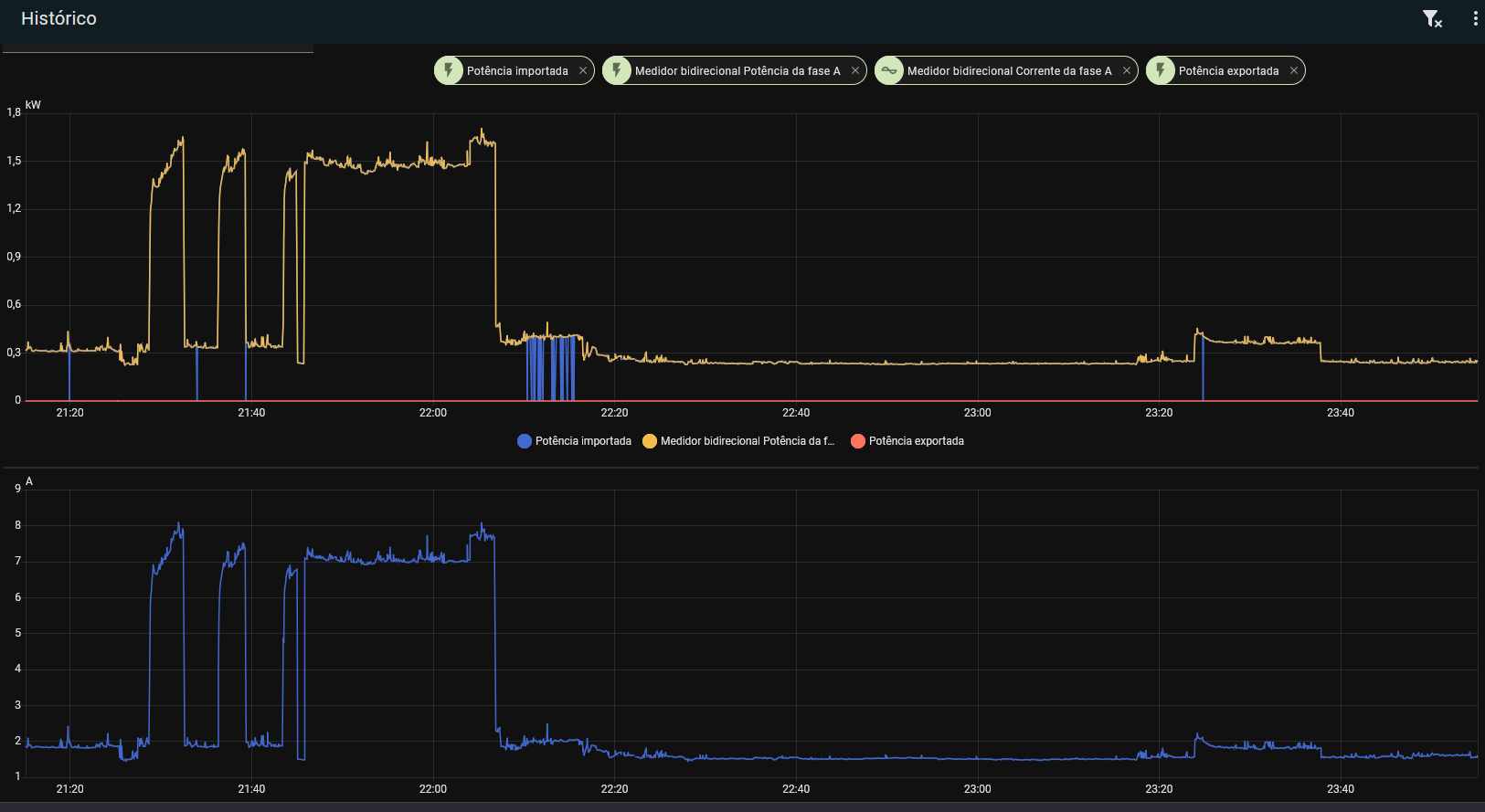

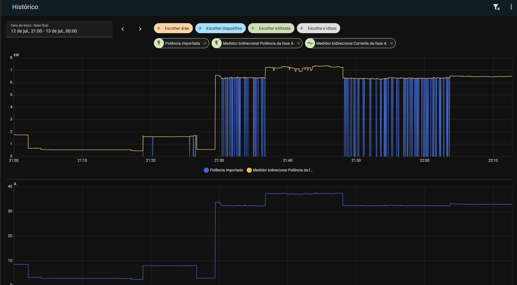

Context: I have a bidirectional power meter, but that meter will not separately report incoming and exporting power. This is signaled using the 3rd digit of current measurement.
I have prepared a code that will isolate incoming and exporting power, but you will see that it will fail in certain circumstances, despite current signal being present and stable.
Can you help me pinpointing what is the cause and solution? Thanks in advance.

It doesn’t appear to be failing, it is going to zero, presumably because the third decimal place of the current sensor is not zero.
Why don’t you zoom into a time when the template sensor drops to zero and see what the value is of the current sensor at that exact time?
Dear @Sir_Goodenough and @mekaneck, I have taken your comments in consideration and have the following response:
1 - I could not find deviations for the value from the current sensor in the third decimal place. I have observed the dashboard in critical moments, in History graph and downloaded data (csv).
