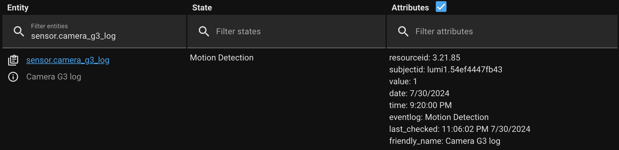

can u go to dev tools states and show us exactly what sensor.camera_g3_log attributes values are
I think you are comparing timezones aware datetime with unaware datetime. Assuming the attributes are local time try this

Unfortunately the sensor is now saying unavailable
sorry, made an update. grab it again?
That did the trick! Thank you so much!!
