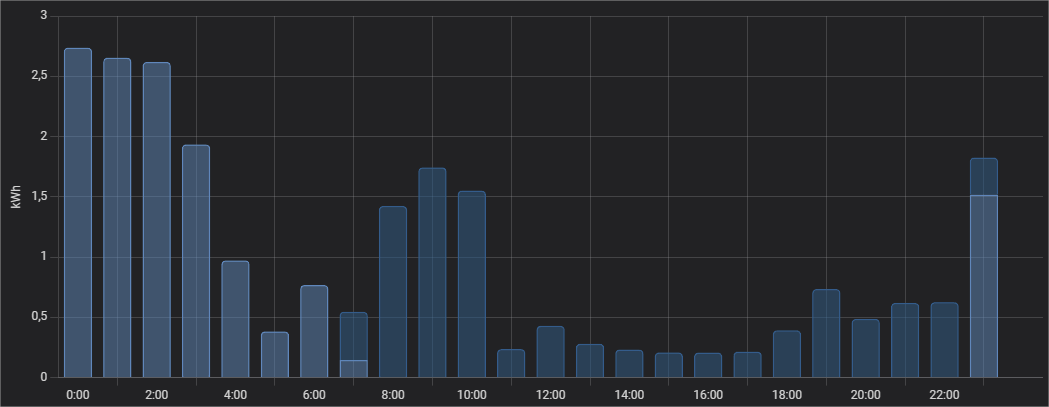

All that makes my system working: my data is well read and transfered to the Energy panel.

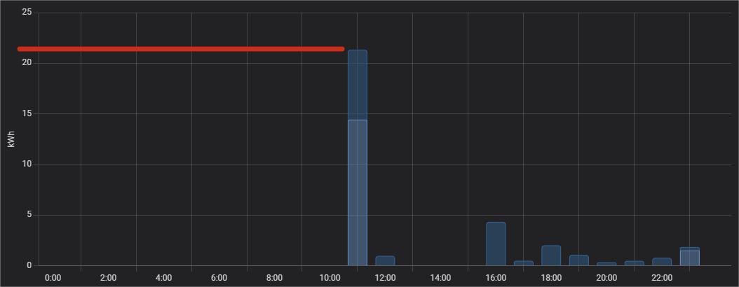

The point is that when an error occurres, or I have to reset HA, The templates are reset and take the default values. which makes the energy data to explode:
(“normal day”:slight_smile:
Do you have an idea how get ride of the inconsistent value attribute? Maybe replacing “allow_create: false” attribute to the zha_toolkit service data…
