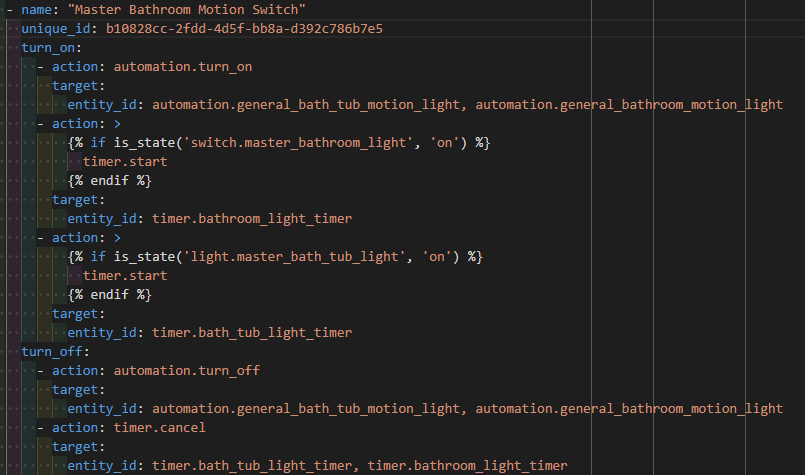

When I don’t use any templating in the template switch turn_on service, the switch does what it’s supposed to. However the moment I add templating to the turn_on service, I get errors in the log and the switch doesn’t work. I can’t figure out what I’m doing wrong. Looked at various examples and postings online, but everything I find is from years ago and not syntactically correct. Is templating not allowed in a template switch’s turn_on service?

Your templated actions don’t have a value if the lights are any state but “on”…
I would use YAML script syntax controls like If/Then actions and/or move the whole action sequence to a Script and call the script as the turn_on action.

- name: "Master Bathroom Motion Switch"
      unique_id: b10828cc-2fdd-4d5f-bb8a-d392c786b7e5
      turn_on:
        - action: automation.turn_on
            entity_id: automation.general_bath_tub_motion_light, automation.general_bathroom_motion_light
        - action: >
            {% if is_state('switch.master_bathroom_light', 'on') %}
              timer.start
            {% endif %}
            entity_id: timer.bathroom_light_timer
        - action: >
            {% if is_state('light.master_bath_tub_light', 'on') %}
              timer.start
            {% endif %}
            entity_id: timer.bath_tub_light_timer
      turn_off:
        - action: automation.turn_off
        - action: timer.cancel
            entity_id: timer.bath_tub_light_timer, timer.bathroom_light_timer

When the light is off this resolves to a target with a null action, which is invalid:
        - action: >
              timer.start
            {% endif %}
resloves to:
        - action: >
You can have an empty turn_on block if the conditions aren’t what you need but you can’t have “half” an action config.
You need to provide an else case or do it a different way. In fact you don’t even need templates.
