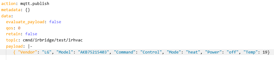

Template to json publish via mqtt to control LG ac via tasmota irbridge
I try to controle my LG ac unit via tasmota irbridge.
It works with a static json
but I want to use a helper to set the temperature.and I needto use a template.

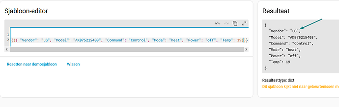

I tested it in the template in and this looks ok (same message as before, no dynamics)

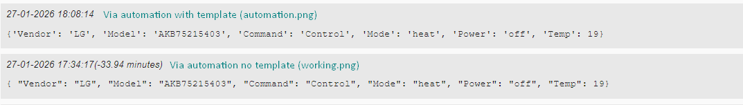

But if it is send via mqtt by an automation, the " are replaced with ’
The AC doesn’t understand the message wit the ’ ilo of the "
Can somebody help?
Regards
Johan

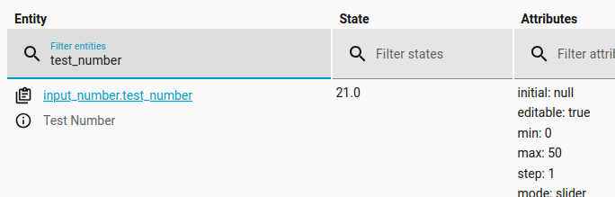

Here is how I recommend you do it. Replace input_number.test_number with the entity_id of your Input Number helper (or whatever helper you are using to store the temperature value).

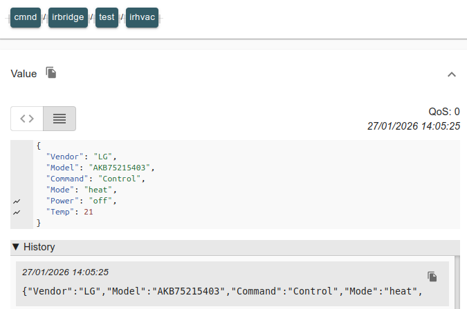

Here is how the published payload appears in MQTT Explorer.
It is properly formatted JSON and the value of Temp is 21 which is the value of input_number.test_number.

Thank you for the fast reply.

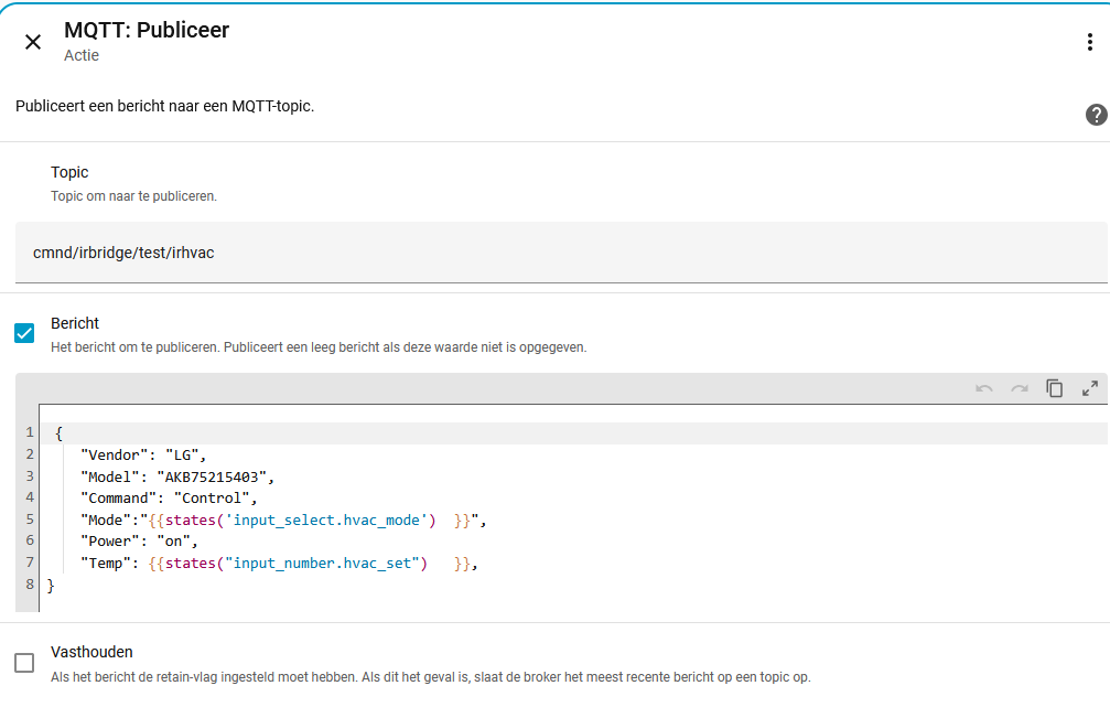

I did copy your suggestion in an automation and tried to execute the action
but I get a failurecode ‘Unable to determine action @ data[0]’.

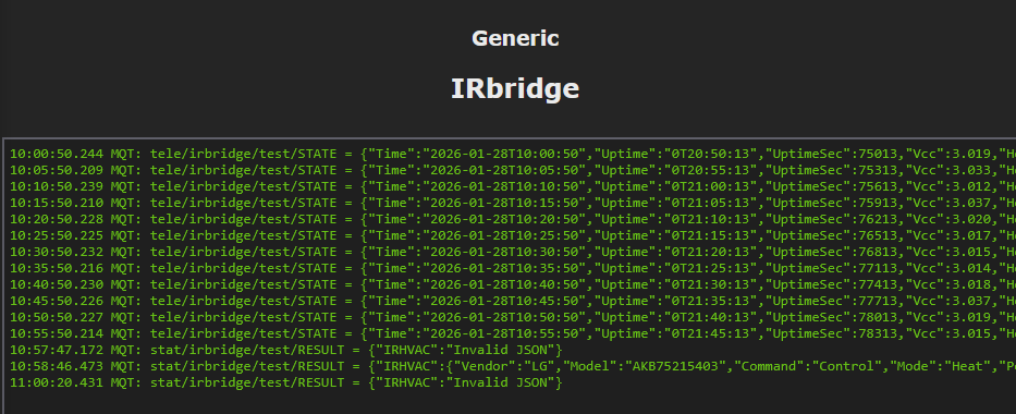

If I send the mqtt message with " then it works and tehe AC reacts.
If it is send with ’ the AC doesn’t react.
In the template editor it all looks ok (editor.pgn) but if I use a automation to send the message I receive it with ’ ilo ".
Is this a bug or a mistake from my side? Or is tasmota to picky?
After some more testing it looks like that tasmota doesn’t accept the ’ .(with the ’ it is indeed an invalid json format)
Why are the " switched to ’ if I use the template in an action, in the editor the result looks ok.
The solution was simple, (as alway :grinning:)
I was just formating the message wrong in the mqtt action.
It works fine now.
Thank you all for pointing me in the right direction.
This topic also pointed me to the solution.
The screenshot shows you copied the YAML code in the wrong place. All of that YAML does not belong in the “MQTT: Publiceer” action.
The YAML code I posted represents the actions section of an automation. It is not a single action but an entire actions section. I assumed you would use it to replace your existing automation’s entire actions section. You copied it into the mqtt.publish (MQTT: Publiceer") action and that’s why you got an error message (Unable to determine action).
That’s why my example uses a variable (cmd) to handle the JSON payload’s formatting. It makes it simpler to publish it in JSON format (using the to_json filter) instead of fussing with the correct order and quantity of double-quotes (") and commas (,).
