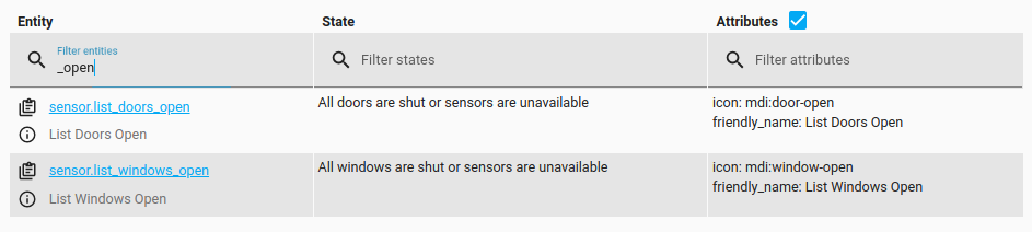

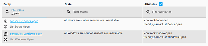

The code looks fine and works here, although there is no need to use a namespace (see Taras’s rewrite). Your code from above included in my config, completely unchanged except for matching indent level with my setup (where there are no door or window sensors):
My guess is that you have enough doors open that the list exceeds the 255-character limit of the sensor state; there should be a related error in the logs.
Close some doors and it should start working :slight_smile: . If it does, you can turn the state into a count, and move the list of names into an attribute, which has a much higher size limit.
You might also find your window version fails if you open a lot of windows.
