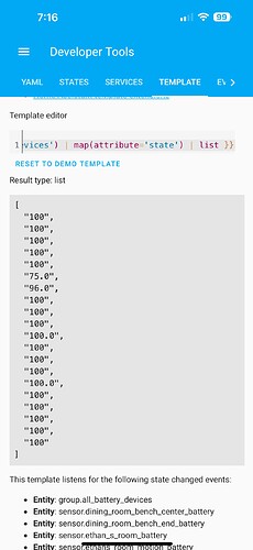

Copy-paste the following template into the Template Editor. What is the result?
{{ expand('group.all_battery_devices') | map(attribute='state') | list }}
It should be a list containing the state value of each sensor.
Yes it is !

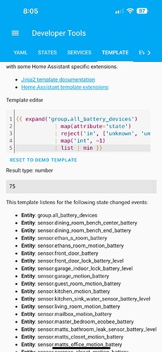

Good. So what does this report?
            | reject('in', ['unknown', 'unavailable'])
            | map('int', -1)
            | list | min }}
It should report 75.
Yes it does ! Thank you for your continued help by the way.
The template sensor works as expected. I have tested it.
