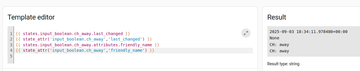

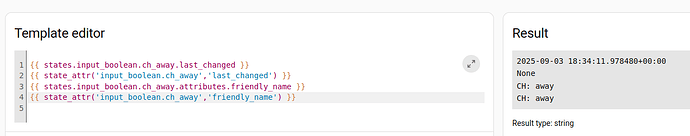

The first one isn’t looking in the attributes dictionary: the comparison isn’t what your title suggests.
last_changed is a property of the State object, not one of its attributes. That’s why state_attr can’t find it.
The methods in your title are mostly equivalent when you are actually looking at attributes:
Petro also wrote a very good explainer post on attributes v properties: Last_updated State and last-changed in Lovelace - #2 by petro
