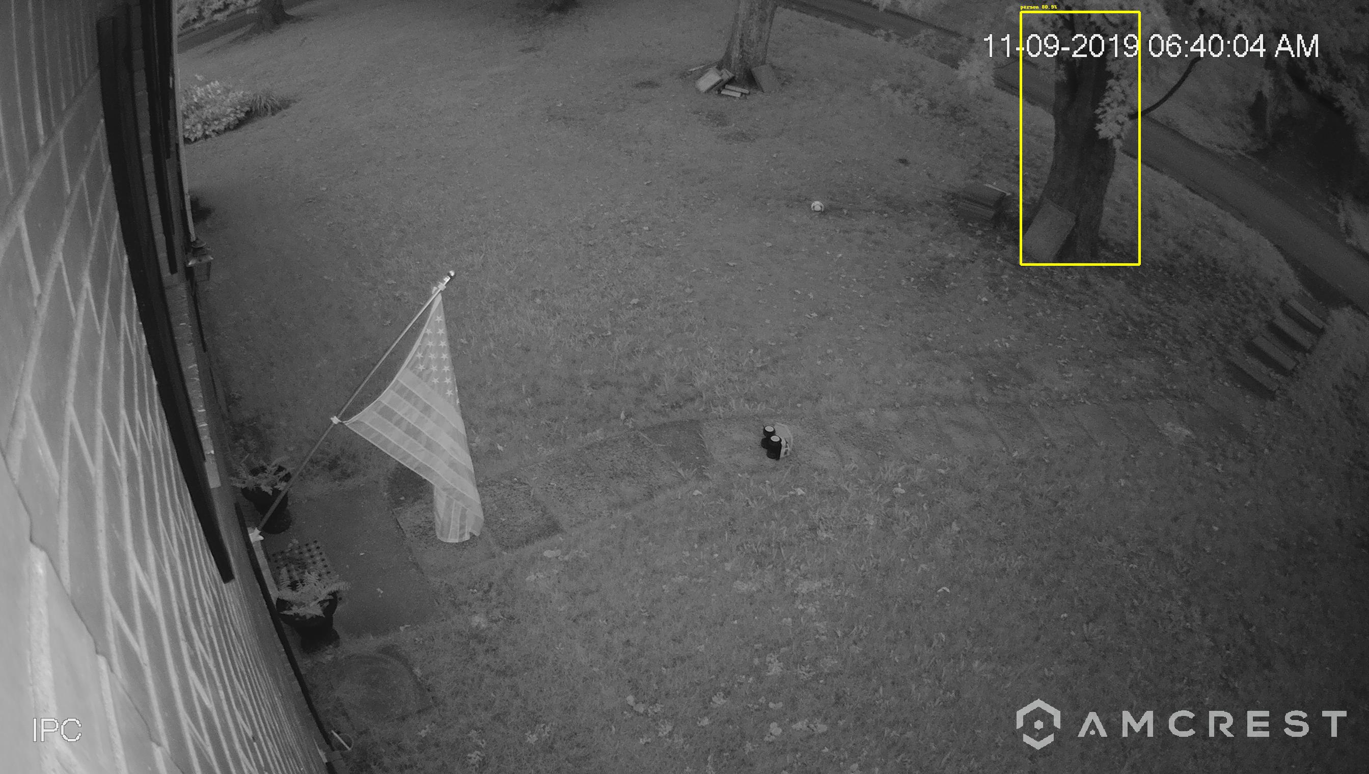

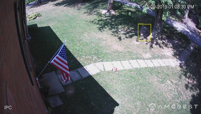

The only false alerts I still have are in on the camera in the garage because the camera is of low quality and does not have IR for night so whenever there’s noise on the feed (a lot during dark times), it triggers motion and TF returns false alerts for shadows that it thinks is a person. I’v further reduced the false notifications by only being alerted when the probability / confidence of a person is above 90%:

its all about the angle and cats position…normally when they stop to clean themselves on my path they get detected as a person lol…hell i have seen shadows and crows detected as people…even chicken wire lmao
yea until we can start training images you have to look and see why it looks like that lol…the bottom of the yellow border could look like a pair of legs

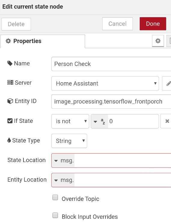

After triggering the TensorFlow scan use a current state node to pull in the results - here I have it check if the person detection is greater than 0 (I have it setup only to check for person - nothing else - so anything over 0 is a person).
After that I use a function node, but what you are looking for is msg.data.attributes.matches.person[0].score.
So you’ll want to use a function, or template, or some other node to compare that value.
My function node does the comparison and also builds a message to be sent to my phone - so much of it is not relevant. I can trim it down later when I am home and have time and reply here if someone doesn’t give a version before then.
OKay, here is a slimmed down version of my function node.
It sets the variable “score” to the confidence of the tensorflow scan.
Then if this is above 90%, it generates a payload message.
The next step is to do a service call to my notification in HA.
Since I write this into the message payload, it is automatically used as the service call payload.
