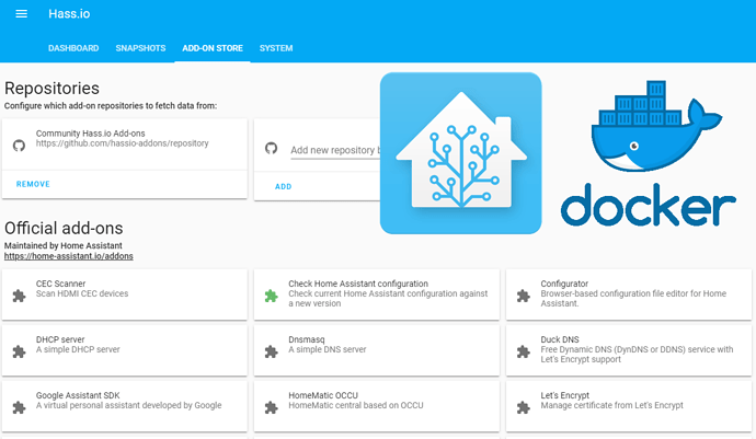

@rabeliyo, I’m having the same issue. Did you install hassio on the NUC directly from the default install on the home-assistant website?
@thefarelkid, I have tried 2 types of installations, the special one for NUC from the official hassio website, and the one I currently have with ubuntu + docker + hassio, the latter, I followed the instructions on this site
Neither installation lets me start if I put image processing component
