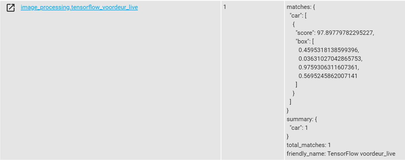

In my case i have it on my frontdoor (Doorbird) :
Which gives me an output of:
You can use templating to grab the correct thing you want:

Which gives me a nice:
And so you can use that for your automation.
A word of caution here though, if you have multiple cars in the picture it won’t work with the template above. Since its my driveway there is always 1 car only. It sometimes comes back with persons too but thats fine.
