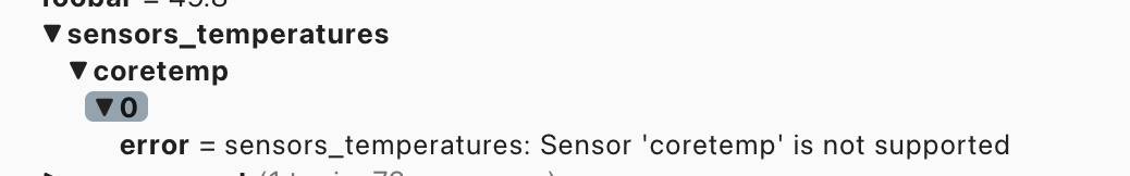

Hi, thanks for the links and help, everything worked out! The only thing I couldn’t get was the CPU temperature, do you know how to fix the code? The device is terramaster f2-212. I also tried to get the fan data, but I’m new to this and it hasn’t worked yet
@Triplid I think the F2-212 would be similar to my TNAS, so try this:
schedule:
  - cron: "every 1 minute"
    tasks:
      # cpu temp
      - task: sensors_temperatures
        params: [ rtk_thermal, 0 ]
        ha_discovery:
          name: "CPU Temperature"
          unit_of_measurement: "°C"
          platform: sensor
          device_class: temperature
          icon: mdi:thermometer
Unfortunately it didn’t work either, but neural networks helped :slight_smile:
in the end it worked - [ cpu-thermal, 0 ]
