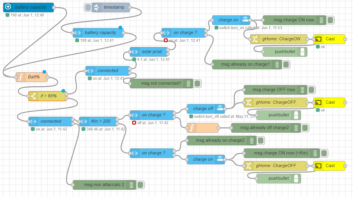

What I have make is an automation that send the Photovoltaic current to Tesla M3 car,
when I have more than 1 kWh Photovoltaic production and the Tesla Powerwall battery is near full.
And also remove the charger when the Tesla Powerwall is less than 95%
and I already have more than 200Km on Tesla car.
So the easy way to do all this is to use the HASSIO integration
of Tesla car and Tesla Powerwall variables.
The problem is that when I arrive home and put the charger on Tesla, the HASSIO variable
binary_sensor.tesa_charger_sensor is not yet updated cause I have set the scan interval
at 120 min for sleep reason.
Here is the picture of the flow for now:
The think that I need please is a node at the begining, that can force the update
of the binary_sensor.tesa_charger_sensor.
I found a service update_entity and I have try to use it in Node-Red but it’s not work.
I think that this service is used when I want to set an entity with my data and not
for update it with Tesla data.
Can anybady help me with this call service please ?
Thanks in advance
Denis

Do a call service: Button Press
Then look for the button that force update data:
service: button.press
  entity_id: button.YOUR_CAR_force_data_update
data: {}
