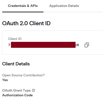

Hello everyone,
I followed the entire registration procedure on the developer.tesla.com website, but when I got to the end of the OAuth 2.0 process, only the “Client ID” appeared, and there is no “Client Secret” anywhere. So, I don’t know what to enter in the configuration of the “Tesla HTTP Proxy” component…
Has this happened to you? Did I do something wrong? What can I do???
ttt
I also have the same problem! Did you find a solution?
You don’t need to choose the open-source software option.
Tesla support wrote to me:
Hey David,
Open source applications documentation will be released and updated soon! For now, you can create an application that is standard application for now until instructions are updated.
Sorry for inconvenience,
Jason
