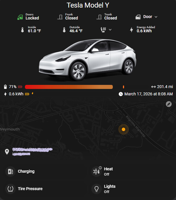

Hi Everyone - me again.

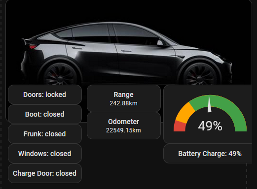

Created a custom Tesla dashboard card and of course a tutorial video to go along with it. Let me know what you think, and if you would like to see more tutorials like this.

So after some more tinkering with the card I have managed to get somewhere, lol. However due to my lack of HA knowledge and coding knowledge I am stuck as to why each entity has a border and isn’t transparent…
I was hoping someone would look at the code and tell what I have done wrong and how to fix it so I can learn and get it working, lol…
type: custom:button-card
show_state: true
tap_action:
  action: none
custom_fields:
  tesla_image1:
    card:
      type: picture
      image: /api/image/serve/57c9bbea6bb306cc1674f2ab92686565/512x512
      card_mod:
        style: |
          ha-card {
            background-color: transparent;
            border: none;
      tap_action:
        action: call-service
        service: input_number.set_value
          entity_id: input_number.tesla_card_height
          value: 500
  tesla_doors:
    card:
      type: custom:mushroom-template-card
      primary: "Doors: {{states('lock.kaylee_doors')}}"
      secondary: ""
      multiline_secondary: false
      fill_container: false
      card_mod:
        style:
          mushroom-state-info$: |
            .primary {
              font-size: 12px !important;
              position: relative;
              overflow: visible !important;
              text-align:left;
            .secondary {
              position: relative;
              text-align:left;
            ha-card {
              border: none;
  tesla_trunk:
    card:
      primary: "Boot: {{states('cover.kaylee_trunk_2')}}"
      secondary: ""
      card_mod:
        style:
            .primary {
              position: relative;
              text-align:left;
            .secondary {
              position: relative;
              text-align:left;
            ha-card {
              border: none;
  tesla_frunk:
    card:
      primary: "Frunk: {{states('cover.kaylee_frunk_2')}}"
      secondary: ""
      card_mod:
        style:
            .primary {
              position: relative;
              text-align:left;
            .secondary {
              position: relative;
              text-align:left;
            ha-card {
              border: none;
  tesla_windows:
    card:
      primary: "Windows: {{states('cover.kaylee_windows')}}"
      secondary: ""
      card_mod:
        style:
            .primary {
              position: relative;
              text-align:left;
            .secondary {
              position: relative;
              text-align:left;
            ha-card {
              border: none;
  tesla_chargerdoor:
    card:
      primary: "Charge Door: {{states('cover.kaylee_charger_door')}}"
      secondary: ""
      card_mod:
        style:
            .primary {
              position: relative;
              text-align:left;
            .secondary {
              position: relative;
              text-align:left;
            ha-card {
              border: none;
  tesla_battery_percent:
    card:
      primary: "Battery Charge: {{states('sensor.kaylee_battery')}}%"
      secondary: null
      card_mod:
        style:
            .primary {
              font-size: 45px !important;
              position: relative;
              text-align:center;
            .secondary {
              font-size: 18px !important;
              position: relative;
              text-align:center;
            ha-card {
              background-color: black;
              border: none;
              z-index: 100;
  tesla_battery_graph:
    card:
      type: gauge
      entity: sensor.kaylee_battery
      needle: true
      severity:
        green: 30
        yellow: 10
        red: 0
      min: 0
      max: 100
      card_mod:
        style: |
          ha-card {
              border: none;
          .name {
            font-size: 14px !important;
            font-weight: 900;
            font-style:italicl;
            position: absolute;
            bottom: 85px;
  tesla_range:
    card:
      primary: Range
      secondary: "{{states('sensor.kaylee_range')}}km"
      card_mod:
        style:
            .primary {
              position: relative;
              text-align:left;
            .secondary {
              position: relative;
              text-align:left;
            ha-card {
              border: none;
  tesla_odo:
    card:
      primary: Odometer
      secondary: "{{states('sensor.kaylee_odometer_2')}}km"
      card_mod:
        style:
            .primary {
              font-size: 10px !important;
              position: relative;
              text-align:left;
            .secondary {
              position: relative;
              text-align:left;
            ha-card {
              border: none;
styles:
  card:
    - align-self: start
    - width: 500px
    - height: 900px
    - opacity: 1
    - background-color: transparent
    - border: none
  custom_fields:
    tesla_image1:
      - position: absolute
      - top: 1px
      - left: 0px
      - width: 500px
    tesla_doors:
      - top: 175px
      - left: 5px
      - width: 150px
    tesla_trunk:
      - top: 215px
      - left: 5px
      - width: 150px
    tesla_frunk:
      - top: 255px
      - left: 5px
      - width: 150px
    tesla_windows:
      - top: 295px
      - left: 5px
      - width: 150px
    tesla_chargerdoor:
      - top: 335px
      - left: 5px
      - width: 150px
      - top: 295px
      - left: 320px
      - width: 190px
      - top: 175px
      - left: 320px
      - width: 190px
    tesla_range:
      - top: 175px
      - left: 165px
      - width: 150px
    tesla_odo:
      - top: 230px
      - left: 165px
      - width: 150px

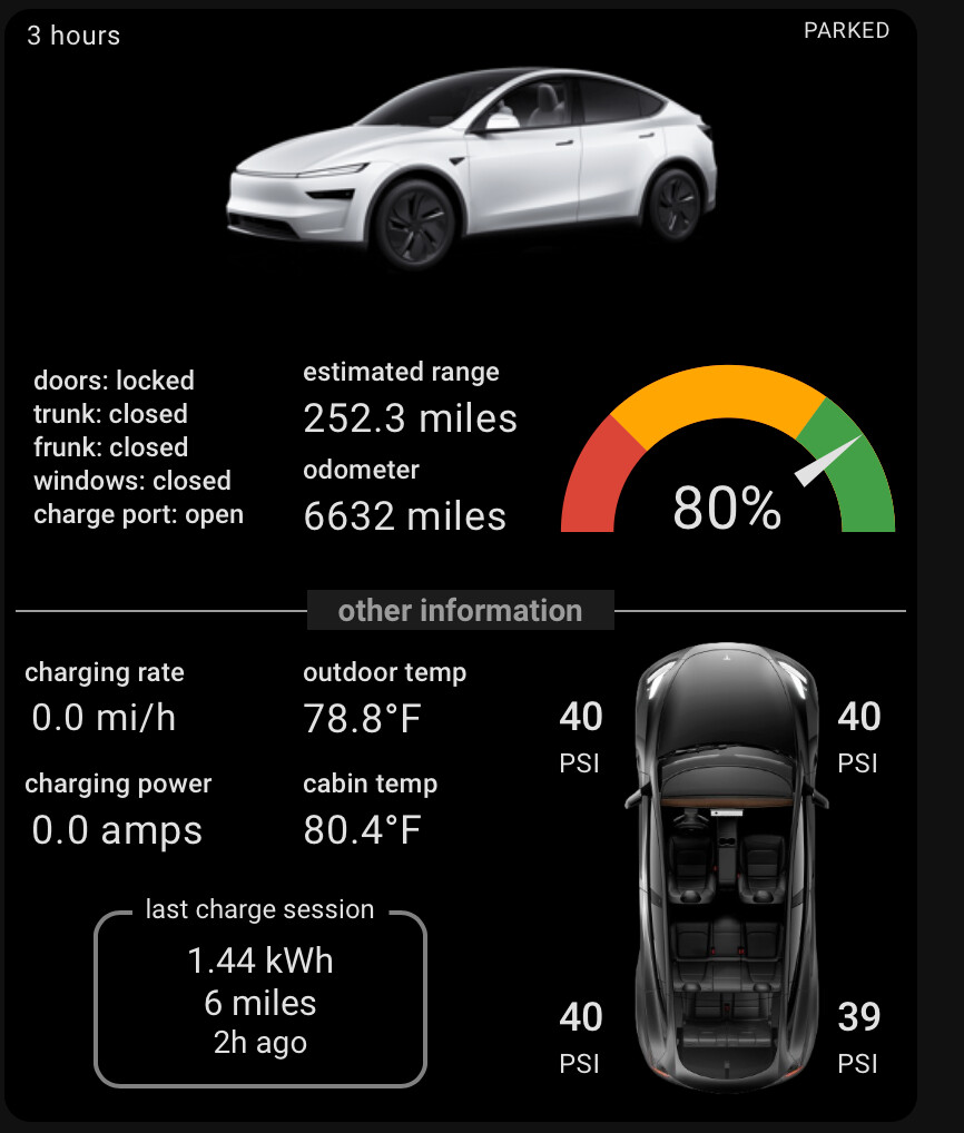

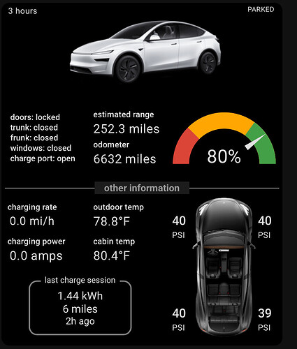

Thank you
I’m in the same situation, have you managed to solve this?
you can try this ive also added km to miles conversion for my card and works great
show_state: true
tap_action:
  action: none
custom_fields:
  tesla_image1:
    card:
      type: picture
      image: local/2.png
      card_mod:
        style: |
          ha-card {
            border: none;
      tap_action:
          value: 500
  tesla_image2:
    card:
      type: picture
      image: /local/teslaTopDown.png
      card_mod:
        style: |
          ha-card {
            border: none;
      tap_action:
          value: 260
  tesla_battery_image:
    card:
      type: picture
      image: local/UMDPhoneBattery2.gif
      card_mod:
        style: |
          ha-card {
            border: none;
  tesla_doors:
    card:
      primary: "doors: {{states('lock.boomer_doors')}}"
      secondary: ""
      card_mod:
        style:
            .primary {
              position: relative;
              text-align:left;
            .secondary {
              position: relative;
              text-align:left;
            ha-card {
              border: none;
  tesla_trunk:
    card:
      primary: "truck: {{states('cover.boomer_frunk')}}"
      secondary: ""
      card_mod:
        style:
            .primary {
              position: relative;
              text-align:left;
            .secondary {
              position: relative;
              text-align:left;
            ha-card {
              border: none;
  tesla_frunk:
    card:
      primary: "frunk: {{states('cover.boomer_frunk')}}"
      secondary: ""
      card_mod:
        style:
            .primary {
              position: relative;
              text-align:left;
            .secondary {
              position: relative;
              text-align:left;
            ha-card {
              border: none;
  tesla_windows:
    card:
      primary: "windows: {{states('cover.boomer_windows')}}"
      secondary: ""
      card_mod:
        style:
            .primary {
              position: relative;
              text-align:left;
            .secondary {
              position: relative;
              text-align:left;
            ha-card {
              border: none;
  tesla_chargerdoor:
    card:
      primary: "charger: {{states('cover.boomer_charger_door')}}"
      secondary: ""
      card_mod:
        style:
            .primary {
              position: relative;
              text-align:left;
            .secondary {
              position: relative;
              text-align:left;
            ha-card {
              border: none;
    card:
      primary: "{{states('sensor.boomer_battery')}}%"
      secondary: null
      card_mod:
        style:
            .primary {
              position: relative;
              text-align:center;
            .secondary {
              position: relative;
              text-align:center;
            ha-card {
              border: none;
              z-index: 100;
    card:
      type: gauge
      entity: sensor.boomer_battery
      needle: true
      severity:
        green: 70
        yellow: 25
        red: 0
      min: 0
      max: 100
      card_mod:
        style: |
          ha-card {
              border: thin;
          .name {
            font-weight: 900;
            font-style:italicl;
            position: absolute;
            bottom: 85px;
  tesla_range:
    card:
      primary: estimated range
      secondary: "{{ (states('sensor.boomer_range') | float * 0.621371) | round(2) }}mi"
      card_mod:
        style:
            .primary {
              position: relative;
            .secondary {
              position: relative;
              overflow: hidden !important;
              text-align:left;
            ha-card {
              border: none;
  tesla_odo:
    card:
      primary: odometer
      secondary: "{{ (states('sensor.boomer_odometer') | float * 0.621371) | round(0) }}mi"
      card_mod:
        style:
            .primary {
              position: relative;
              text-align:left;
            .secondary {
              position: relative;
              text-align:left;
            ha-card {
              border: none;
  divider1:
    card:
      type: custom:text-divider-row
      text: information
      align: center
      text-divider-color: white
  tesla_front_right_tire:
    card:
      primary: "{{states('sensor.boomer_tpms_front_left') | round}}"
      secondary: PSI
      card_mod:
        style:
            .primary {
              position: relative;
              text-align: left;
            .secondary {
              position: relative;
              text-align: left;
            ha-card {
              border: none;
  tesla_front_left_tire:
    card:
      secondary: PSI
      card_mod:
        style:
            .primary {
              position: relative;
              text-align: left;
            .secondary {
              position: relative;
              text-align: left;
            ha-card {
              border: none;
  tesla_rear_left_tire:
    card:
      primary: "{{states('sensor.boomer_tpms_rear_left') | round}}"
      secondary: PSI
      card_mod:
        style:
            .primary {
              position: relative;
              text-align: left;
            .secondary {
              position: relative;
              text-align: left;
            ha-card {
              border: none;
  tesla_rear_right_tire:
    card:
      primary: "{{states('sensor.boomer_tpms_rear_right') | round}}"
      secondary: PSI
      card_mod:
        style:
            .primary {
              position: relative;
              text-align: left;
            .secondary {
              position: relative;
              text-align: left;
            ha-card {
              border: none;
  tesla_charging_rate:
    card:
      primary: charging rate
      secondary: >-
        {{ (states('sensor.boomer_charging_rate') | float * 0.621371) | round(2)
        }} mi/h
      card_mod:
        style:
            .primary {
              position: relative;
              text-align:center;
            .secondary {
              position: relative;
              text-align:center;
            ha-card {
              border: none;
  tesla_charging_power:
    card:
      primary: charging power
      secondary: "{{states('sensor.boomer_charger_power')}} amps"
      card_mod:
        style:
            .primary {
              position: relative;
              text-align:center;
            .secondary {
              position: relative;
              text-align:center;
            ha-card {
              border: none;
  tesla_outdoor_temp:
    card:
      primary: outdoor temp
      secondary: "{{states('sensor.boomer_temperature_outside')}}°c"
      card_mod:
        style:
            .primary {
              position: relative;
              text-align:center;
            .secondary {
              position: relative;
              text-align:center;
            ha-card {
              border: none;
  tesla_inside_temp:
    card:
      primary: cabin temp
      secondary: "{{states('sensor.boomer_temperature_inside')}}°c"
      card_mod:
        style:
            .primary {
              position: relative;
              text-align:center;
            .secondary {
              position: relative;
              text-align:center;
            ha-card {
              border: none;
  tesla_cabin_temp:
    card:
      primary: null
      secondary: "{{states('sensor.boomer_temperature_inside')|round}}°c"
      card_mod:
        style:
            .primary {
              position: relative;
              text-align:center;
            .secondary {
              font-size: 16px !important;
              position: relative;
              text-align:center;
            ha-card {
              border: none;
  tesla_last_charge_stats_box:
    card:
      primary: last charge session
      secondary: null
      card_mod:
        style:
            .primary {
              position: absolute;
              text-align:center;
              top: -10px;
              left: 15px;
              background: black;
              width: 120px;
            .secondary {
              position: relative;
              text-align:center;
            ha-card {
              border-color: grey;
              border: 2.5px thin;
              height: 500px;
              width: 150px;
              height: 80px !important;
  tesla_energy_added:
    card:
      primary: null
      secondary: "{{states('sensor.boomer_energy_added')}} Kwh"
      card_mod:
        style:
            .primary {
              position: relative;
              text-align:center;
            .secondary {
              position: relative;
              text-align:center;
            ha-card {
              border: none;
  tesla_range_added:
    card:
      primary: null
      secondary: >-
        {{ (state_attr('sensor.boomer_energy_added', 'added_range') | float *
        0.621371) | round(2) }} mi
      card_mod:
        style:
            .primary {
              position: relative;
              text-align:center;
            .secondary {
              position: relative;
              text-align:center;
            ha-card {
              border: none;
  tesla_last_update:
    card:
      primary: null
      secondary: "{{ relative_time(sensor.boomer_data_last_update_time) }}"
      icon: mdi:home
      card_mod:
        style:
          mushroom-shape-icon$: |
            .shape {
              --shape-animation: ping 2s infinite;
            @keyframes ping {
                0% {box-shadow: 0 0 0 0 rgba(var(--rgb-red), 0.7);}
                70% {box-shadow: 0 0 0 10px transparent;}
                100% {box-shadow: 0 0 0 0 transparent;}
            ha-card {
              --icon-size: 4px;
              /* Remove default card styling */
              --ha-card-box-shadow: none;
              --ha-card-background: none;
              --ha-card-border-width: 0;
              user-select: none;
              width: 120px;
              border: none;
              background: transparent;
              padding: 0px;
              text-align:left;
            :host {
              /* Match styling to Mushroom Title */
              --mush-card-primary-font-size: 10px;
              --mush-card-primary-font-weight: normal;
              --mush-card-primary-line-height: 10px;
              --mush-card-secondary-font-size: 10px;
              --mush-card-secondary-font-weight: normal;
              --mush-card-secondary-line-height: 10px;
              --mush-card-secondary-color: silver;
  tesla_status:
    card:
      primary: null
      secondary: |
        {% if is_state('sensor.boomer_shift_state','P') %}
          PARKED
        {% elif is_state('sensor.boomer_shift_state','D') %}
          DRIVING
        {% elif is_state('sensor.boomer_shift_state','R') %}
          REVERSE
        {% elif is_state('sensor.boomer_shift_state','N') %}
          NEUTRAL
      card_mod:
        style:
            .primary {
              position: relative;
              text-align:left;
            .secondary {
              position: relative;
              text-align:right;
            ha-card {
              border: none;
styles:
  card:
    - align-self: start
    - width: 410px
    - height: |
        [[[ return states['input_number.tesla_card_height'].state + 'px'; ]]]
    - opacity: 1
    - background-color: black
    - border: none
  custom_fields:
    tesla_image1:
      - top: 10px
      - left: 10px
      - width: 395px
      - top: 226px
      - left: 355px
      - width: 65px
      - visibility: >-
          [[[ if (states["binary_sensor.boomer_charging"].state == "off") return
          "hidden"; ]]]
    tesla_doors:
      - top: 145px
      - left: 10px
      - width: 100px
    tesla_trunk:
      - top: 161px
      - left: 10px
      - width: 100px
    tesla_frunk:
      - top: 177px
      - left: 10px
      - width: 100px
    tesla_windows:
      - top: 193px
      - left: 10px
      - width: 100px
    tesla_chargerdoor:
      - top: 209px
      - left: 10px
      - width: 100px
      - top: 210px
      - left: 275px
      - width: 90px
      - top: 140px
      - left: 230px
      - width: 190px
    tesla_range:
      - top: 145px
      - left: 125px
      - width: 130px
    tesla_odo:
      - top: 189px
      - left: 125px
      - width: 130px
    divider1:
      - top: 250px
      - left: 5px
      - width: 400px
    tesla_image2:
      - top: 275px
      - left: 250px
      - width: 150px
      - top: 295px
      - left: 365px
      - width: 30px
      - top: 295px
      - left: 240px
      - width: 30px
      - top: 430px
      - left: 240px
      - width: 30px
      - top: 430px
      - left: 365px
      - width: 30px
      - top: 280px
      - left: 0px
      - width: 120px
      - top: 330px

After MUCH work I finally got the original card working with my Tesla in the latest (2025.11.3) HA Core.
Since there doesn’t seem to be a way to attach files in replies, I’ll post the updated YAML to my website and post the instructions here in the next day or so.
@nickjhowe
Hey Nick. My card is a mess after the update, if you wouldn’t mind sharing your yaml with me, it would be so nice, or private message me your website so i can grab it there, i was unable to find it. Thanks.
Hey Everyone, here are the instructions for how to make the card work. You can download the 3 required files, including the YAML here
Installation Instructions.
You will need to have HACS installed in Home Assistant.
Use HACS to:
  1. Install Tesla Custom Integration (TCI)
    Follow the instructions on the install documentation
    Note - I did not need to do any of the Fleet API stuff. It worked OOB with my 2026 Juniper and my 2012 Model Y
    I did need to install the Auth App for Tesla (in the TCI installation instructions) and generate the Client ID and Client Secret
    If you have more than one car listed in TCI, enable or disable them as required,
  2. install button card
  3. install card-mod
  4. install mushroom card
  5. Install Text Divider Row
Next, add Helpers (Settings, Devices and Services, Helpers)
  1. Add Helper ā€œnumberā€ called tesla_card_height, click it and set to 500
  2. Add Helper ā€œtextā€ called tesla_car_name and set it to the name of your car (i.e., the one that shows up in the Tesla App)
Next, log into your tesla account tesla.com/teslaaccount
  1. Find the car you want to display on the card and click manage
  2. Right click and save car image as ā€œtesla-car-image.pngā€ (I’ve included my car image so the card will work out of the box)
Next, in HA, go to media (in the sidebar), my media/manage upload tesla-car-image.png and teslaTopDown.png
OK. Everything is now (hopefully) ready to go.
Go to your Dashboard and Edit,
Add Card. choose Manual Card,
Copy and paste the YAML from tesla-custom-card-njh.yaml
Unfortunately, there is one place in the YAML that has the car name hard coded
Edit the YAML
Search and replace ā€œstormā€ (the name of my car) with the name of your car from the tesla app.
Fingers crossed, everything should be there in all its glory.
If you click the main car image the card will expand to include charging and tire pressure info
If you ckick the ā€˜top down’ car image, the card will collapse to hide that info.
If you want, you can also add the automations at 13:23 in the video to open the bottom part of the card automatically when it is charging
Planning improvements:
  1. simplify so that mushroom card is not needed.
Note: if you want two cards for two cars, you’ll need to add a new helper called, e.g., tesla_car_name2 (and set it to the name of the 2nd car) and upload a new image tesla_car_image2 and in the 2nd card find and replace all instances of the names.
Note 2: my car is in the US so defaults to miles and deg. F; if you car is reporting in km and deg C, edit the TAML to change the units - they are all hard coded.
I’ve fixed a couple of bugs in the YAML. The link in the previous post points to the latest version.
Fixed - zindex problem; bug in ā€œtime sinceā€ calculation"; incorrect label on charging power

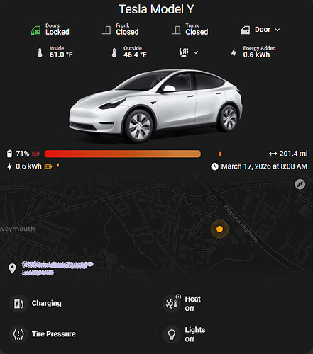

Here is my Y.
type: custom:vehicle-status-card
name: Tesla Model Y
images:
  - image: https://xxx.xxx.xxx/Tesla-White.png

button_cards:
  - layout: horizontal
    transparent: false
    show_primary: true
    show_secondary: true
    show_icon: true
    tap_action:
      action: toggle
    hide_button: false
    button_type: default
    card_type: custom
    icon_type: icon
    primary_info: name
    icon: mdi:ev-station

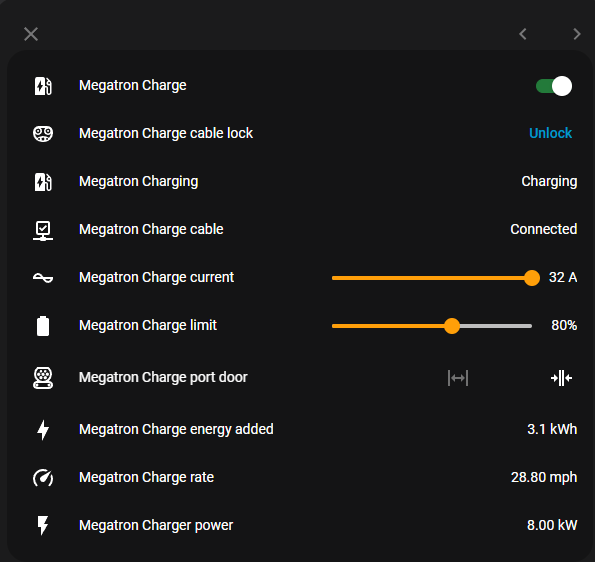

    sub_card:
      custom_card:
        - type: entities
            - entity: switch.tesla_charge
            - entity: lock.tesla_charge_cable_lock
            - entity: sensor.tesla_charging
            - entity: binary_sensor.tesla_charge_cable
            - entity: number.tesla_charge_current
            - entity: number.tesla_charge_limit
            - entity: cover.tesla_charge_port_door
            - entity: sensor.tesla_charge_energy_added
            - entity: sensor.tesla_charge_rate
            - entity: sensor.tesla_charger_power

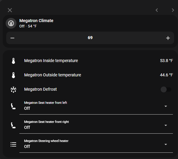

    transparent: false
    show_primary: true
    show_icon: true
    notify: "{{ true }}"
    notify_color: >-
      {{ iif (is_state('climate.tesla_climate', 'on'), 'mdi:heat-wave',
      'mdi:heat-wave') }}
    notify_icon: "{{ iif (is_state('climate.tesla_climate', 'on'), '#FAF625') }}"
    tap_action:
      action: toggle
    hide_button: false
    card_type: custom
    icon_type: icon-template
    primary_info: name
    entity: climate.tesla_climate
    icon_template: >-
      'mdi:snowflake-thermometer', 'mdi:snowflake-thermometer') }}
    color_template: "{{ iif (is_state('climate.tesla_climate', 'on'), '#F52727') }}"
    include_state_template: true
    state_content:
      - state_template
    sub_card:
      default_card:
        - title: New Category
          items:
            - entity: climate.tesla_climate
          collapsed_items: true
          state_color: false
          items:
      custom_card:
        - type: custom:mushroom-climate-card
          fill_container: true
          show_temperature_control: true
          collapsible_controls: false
          hvac_modes:
            - auto
            - heat
            - cool
        - type: entities
            - entity: sensor.tesla_inside_temperature
            - entity: sensor.tesla_outside_temperature
            - entity: switch.tesla_defrost
            - entity: select.tesla_seat_heater_front_left
            - entity: select.tesla_seat_heater_front_right
            - entity: select.tesla_steering_wheel_heater
