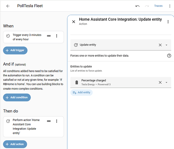

I’m not sure how often default Tesla fleet API integration was polling but I disabled polling for changes and added an automation to try and update it every three minutes.
