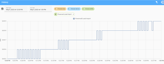

I am having a similar issue.
Some time in early March my basic daily cycle utility meters started to over-report on load (but seemingly not on solar generation or site export/import).
The load utility meter is on sensor.powerwall_load_import.
I have not investigated this at all yet.
I opened this bug and incorrectly suspected it might be day light savings related, but I have since found another workaround - creating a Reimann Sum Integral Sensor off of sensor.powerwall_load_now instead of using sensor.powerwall_load_import directly. Another person has found that toggling “net consumption” works for them on the utility meter…I just created a sensor to test this to see if it helps. It just doesn’t make sense to me given that the historical data on the sensor does not match the expected daily values.
I have changed my utility meters to be net consumption and everything looks good again.
Does anyone know why this net consumption toggle would make the difference? The history on the sensor doesn’t show appear to go down, so it doesn’t make sense to me that this would be required.
I suspect the issue is with the powerwall plugin (or a recent powewall firmware update) as I can see the powerwall_load_import sensor repeatedly increasing and decreasing.
It would also explain why “net consumption” works…
On further digging, this looks like a powerwall firmware issue - the values reported from the API occasionally go backward - this is from the api/meters/aggregates API:
