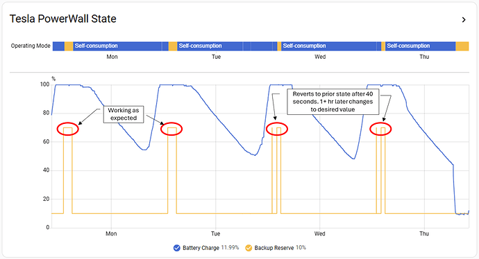

Issue: I noticed that on some days, shortly after the automation runs, the setting revert to their prior values and then change to the desired values over an hour later. Looking at the Activity log, it isn't clear what is triggering these latter two changes (not a rouge automation.) On other days, it works as desired. Has anyone else seen something like this or have ideas about what the root cause might be? (Note: there have not been any changes to the automation recently.)
This shows the state changing unexpectedly on May 12 & 13, but working as expected on May 10 & 11:

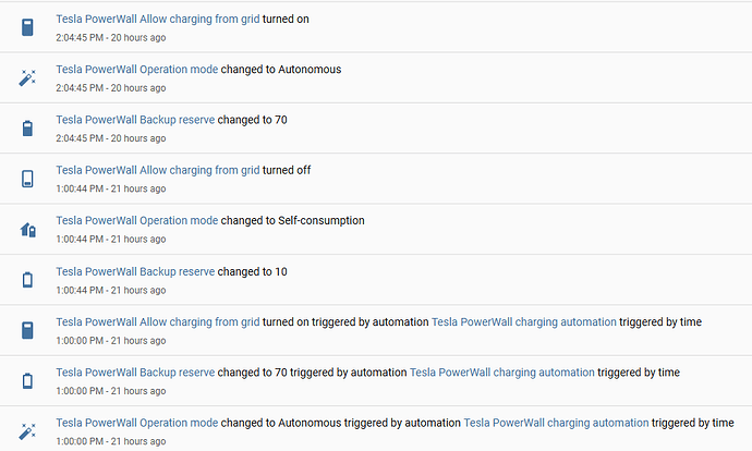

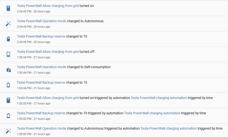

Here is the Activity log from May 13:

One other comment - there are not any entries in the log file around the affected times (e.g., ~1pm, ~2pm) related to the Tesla Fleet integration, etc.
I thought I would follow up with my findings in case anyone runs into a similar issue:
I believe the issue was that occasionally my Tesla Fleet Integration would go offline momentarily when I was trying to update the settings, causing the update to queue up for the next retry. I fixed this by checking the settings after about 1 min and if they didn't change, then I retry the update. This appears to be working.
