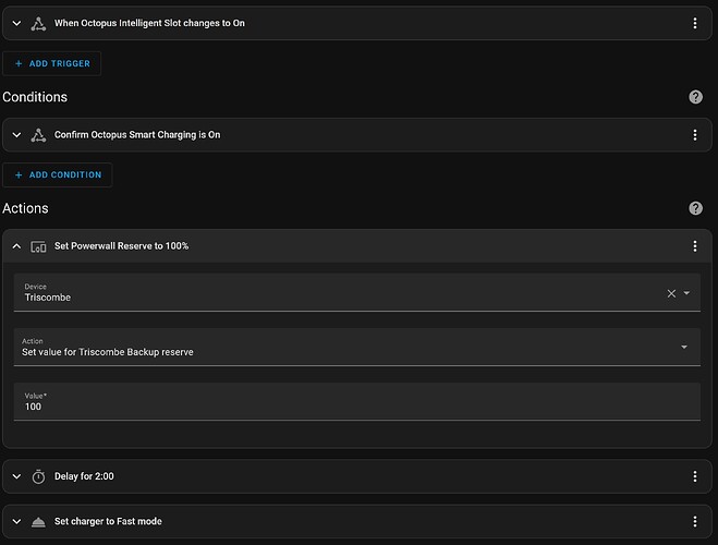

I am new to HA (a few weeks into the journey) so have put these together in the visual editor:
Trigger:
When Octopus Intelligent Slot (binary_sensor.octopus_intelligent_slot) changes to On
Condition:
Confirm Octopus Smart Charging (switch.octopus_smart_charging) is On
Actions:
Set Powerwall Reserve (number.triscombe_backup_reserve) to 100
Delay for 00:02:00
Select ‘Fast’ mode for Zappi charger (select.myenergi_charger_charge_mode)
and the outcome copied from the YAML editor:
alias: When IO slot, Powerwall Reserve 100, Charger Fast
description: >-
  Powerwall Reserve set to 100 when Intelligent Slot on, wait 2 mins, change
  charger to fast mode
trigger:
  - platform: state
    entity_id:
      - binary_sensor.octopus_intelligent_slot
    to: "on"
condition:
  - condition: state
    entity_id: switch.octopus_smart_charging
    state: "on"
action:
  - device_id: 91f9969405d6e6060c8ad47c8bf2f9ef
    domain: number
    entity_id: fee7c88090e153b895a7b0cebec13dc4
    type: set_value
    value: 100
    alias: Set Powerwall Reserve to 100%
  - delay:
      hours: 0
      minutes: 2
      seconds: 0
      milliseconds: 0
  - service: select.select_option
      option: Fast
      entity_id: select.myenergi_charger_charge_mode
    alias: Set charger to Fast mode
mode: single
Then there is an opposite automation to revert back to normal when the Intelligent Slot is over. There may well be ‘better’ ways to achieve this which I will discover as I find out more about HA!

I have managed to do mine as a ‘Device’ Action instead of a Service call. If I add an Action, then choose Device, choose the Powerwall device and then it gives a variety of options, one of which is “Set value for backup reserve”

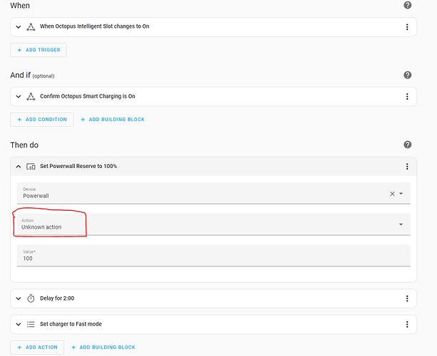

Hi All,
First time posting…
I am trying to get the above working to take advantage of the 15p export tariff. The issue I am having is when I go to select the actions I can only select grid related operations toggle, on, off. Are you able to advise how I have messed this up?
alias: "Powerwall charge to full off peak "
description: “”
trigger:
  • platform: state
    entity_id:
    • binary_sensor.octopus_intelligent_slot
      to: “on”
      condition:
  • condition: state
    state: “on”
    action:
  • device_id: 3f0c1978fd0bb893029a46154b606890
    domain: number
    entity_id: fa148ccafa901f24d52457596562ccc3
    type: set_value
    value: 100
  • delay:
    hours: 0
    minutes: 2
    seconds: 0
    milliseconds: 0
  • service: select.select_option
    option: Fast
    mode: single
then in the other view
the action only allows turning on or off from grid.
Thanks
